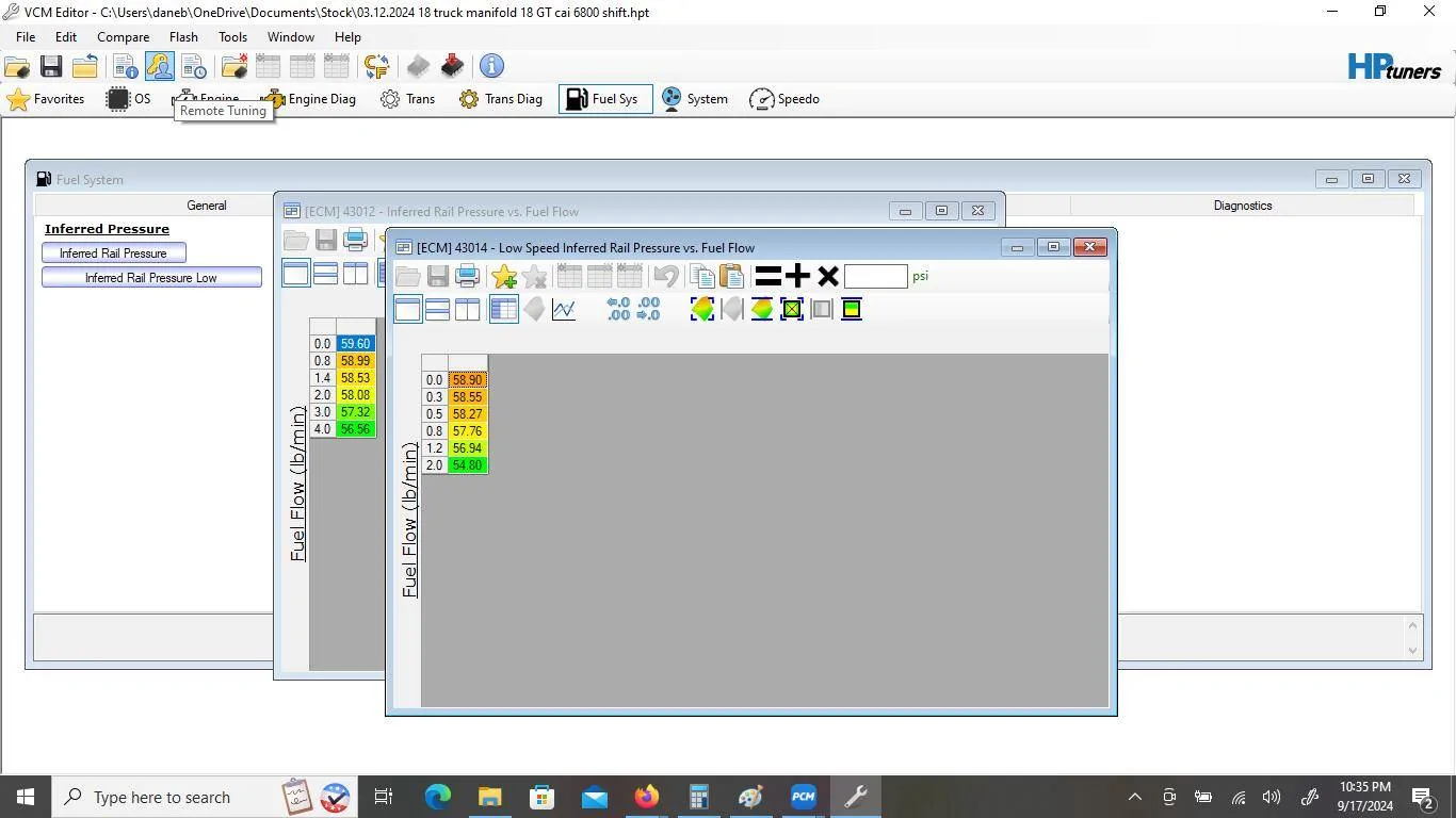

If you have a 16 there is no sensor so no PID the rail pressure is inferred.
Somewhere in all the options there might be a channel that shows what the inferred is. I never looked for it since it is defined in the tune.
