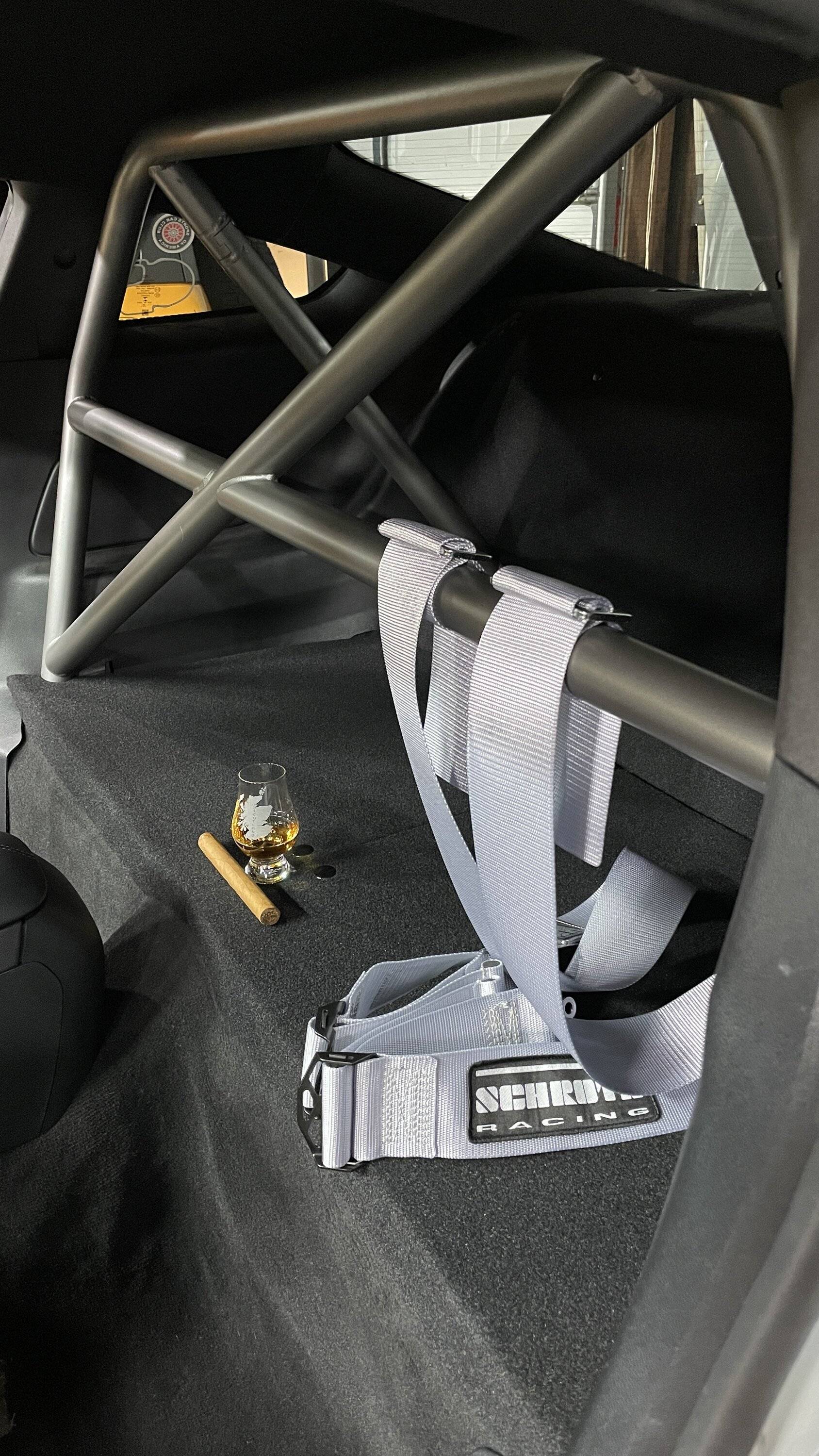

I have this one and use it in conjunction with fixed back race seats. The bar lines up great with the shoulder harness slots in the seats so the angle of the belts over my shoulders is not a concern with compressing my spine in an incident. With stock seats I think the harness bar is too low and causes shoulder belts to have too much angle down off the back of the seat.
I am totally cool with it for an autox setup but makes me nervous on open track. I'm fast enough now with the car that I feel it is time to step up to a 4-point cage and HANS. I think if you're considering something like this for open track use just get a 4-point cage instead.
