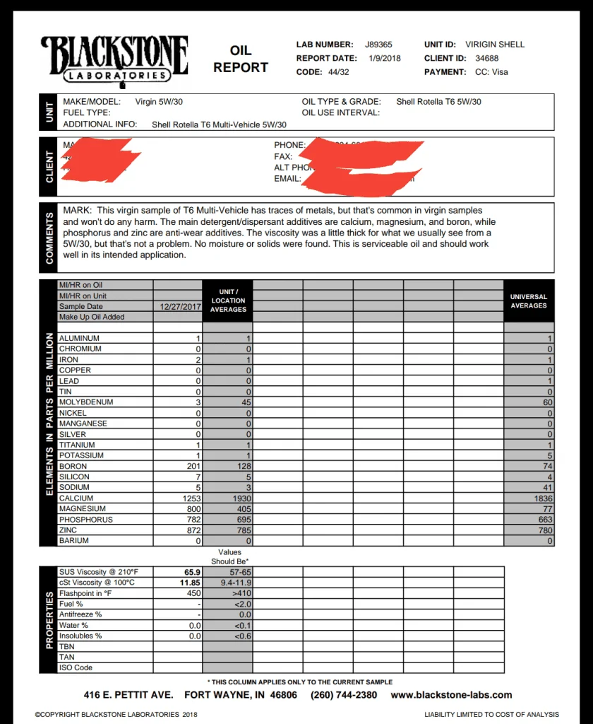

I'm using the new T6 5w-30 Multi Vehicle oil in my '18, I've been using the T6 5w-40 in my SC 3v for the last 5yrs and have no issues with it. I just didn't wanna use a 40weight oil in the 18.
I'm coming up on 7000 miles on the 1st fill, my car has seen very little oil loss, I;ve been beating on my car hard since I bought it [I bought it to Drive it, NOT be a garage queen] I lost about a pint on the original Motorcraft fill, I have topped off about a quart on this fill, That's after a couple dozen 1/8 mile passes, dozen 1/4mile and several trips down to the Mexican border ...
The Multi Vehicle is SN rated, and is as shear stable as the 5w-40. As it is geared more towards gas and small diesel trucks he additive package is different between the new MV and 5w-40.
It has less Calcium but more Magnesium which is where the new SN+ oils appear to be going to help with LSPI if you're concerned about that.
It also has higher Boron for the Ceratec users.

That’s really high viscosity for a 30 weight. Just a touch higher and the bottle would say 40 on it. The boron dose is high but it’s low on phosphorus (to comply with SN) and moly. Fwiw, the t6 5w40 has about the same boron but more ZDTP.

If LSPI is your concern then the rotella MV looks to be a pretty good fit.
