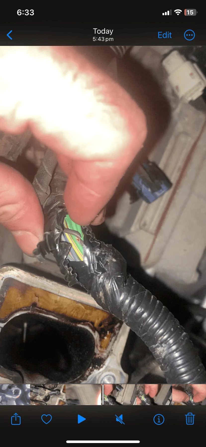

Anyone know what wire I accidentally cut into here?
revolio_gt
Aug 21, 2023
Australia
2016 Mustang GT
Installing an 18+ IM on my 16. There was a zip tie right there that I cut with scissors (pita to get to, on the back of the manifold) but looks like I barely snipped the purple wire. Is that something I need to fix? I am locking out my IMRCs for reference, so maybe I don't need to? How would I even fix it if I do needd to? solder?

I don’t know what it is , but as you only just nicked it And it looks like you only just took the outer plastic off an hit and didn’t cut wire ?? Just electrical tape it and it will be fine.
maybe some close up pics would be better to show us A bit more detail.

Here’s a still from the vid, it’s def severed in 2

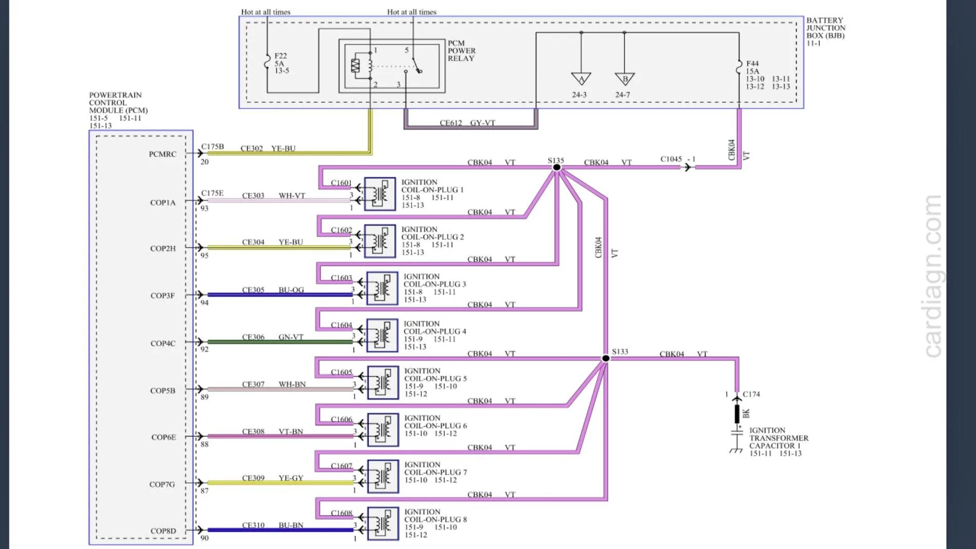

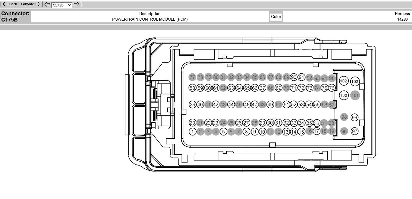

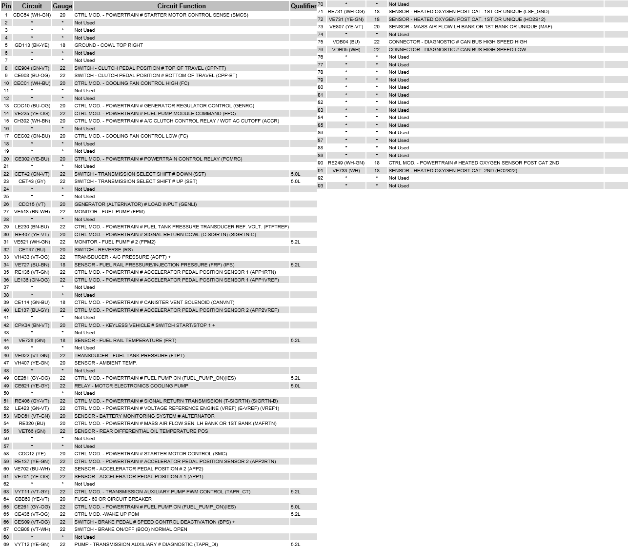

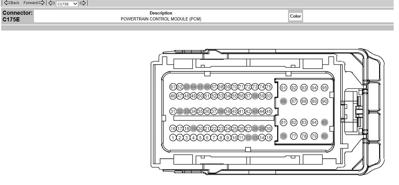

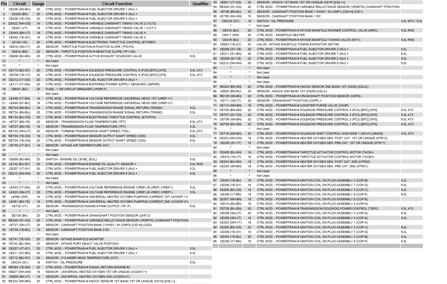

I cannot tell you what the wire is, but the attached might help determining what all is inside that bundle.

Skye
Jan 18, 2022
3,032
4,253
≈39N
"Skye" Mach1 N2144
Two more.
Glad it is one lead. You might spend more time making room for the repair than doing the repair itself.
Good Luck. :please:
