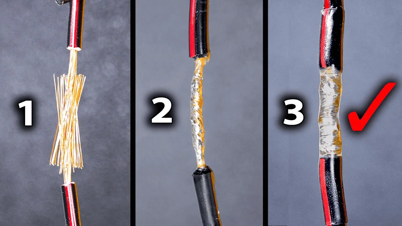

Yes, add wire like @K4fxd said…don’t try and stretch things out, add a loop if needed. And if you didn’t buy the solder-seal connections (overnight from Amazon) then do it like this…
