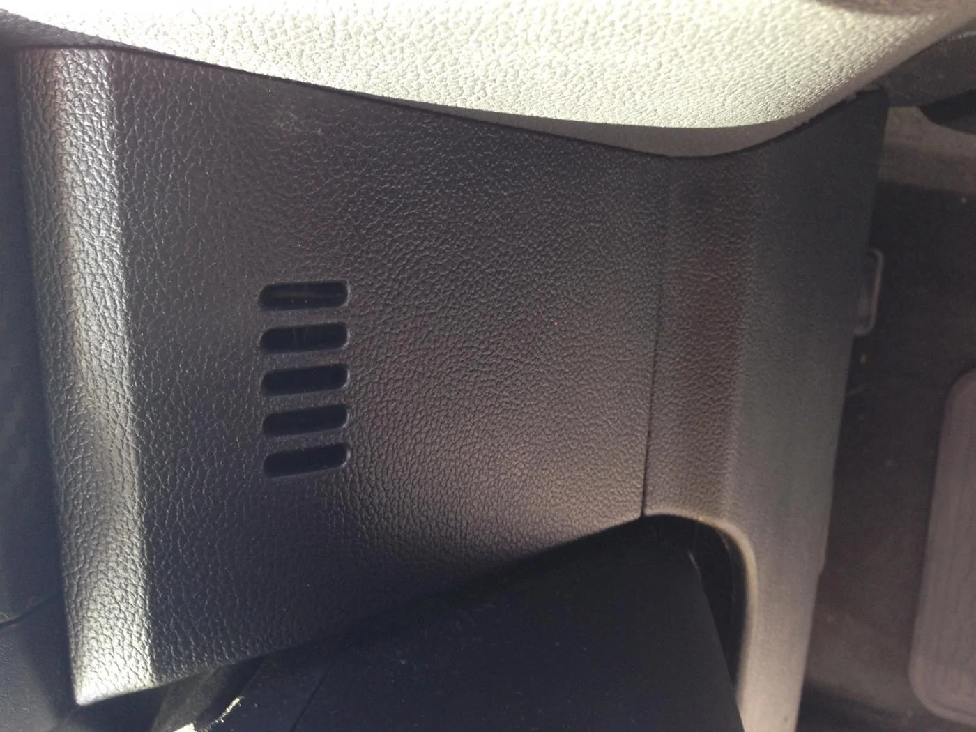

Anyone know what this is?

This small panel sits to the right of the steering column, near the driver's right knee; it has a vent and, when I popped it off to do the install of base radio replacement, it has a wire harness inside.
But no obvious purpose? :shrug:

Temperature sensor for the climate control system.

So on my base model it serves no purpose? Cause there's still a vent there. No clue what, if anything, is behind it though.
I know I have no automatic climate control though.

It's the air temperature sensor for your automatic climate control.
Costs too much to retool the molding.

Well yes, I was mainly wondering if the sensor itself is still in there. If I was to swap in a MFT with the auto climate, would it work properly?
If it does not have automatic climate control, there is no reason to have the sensor.
On some vehicles, the HVAC box is not the same between the auto and manual climate control so it's not as simple as swapping the controls.
