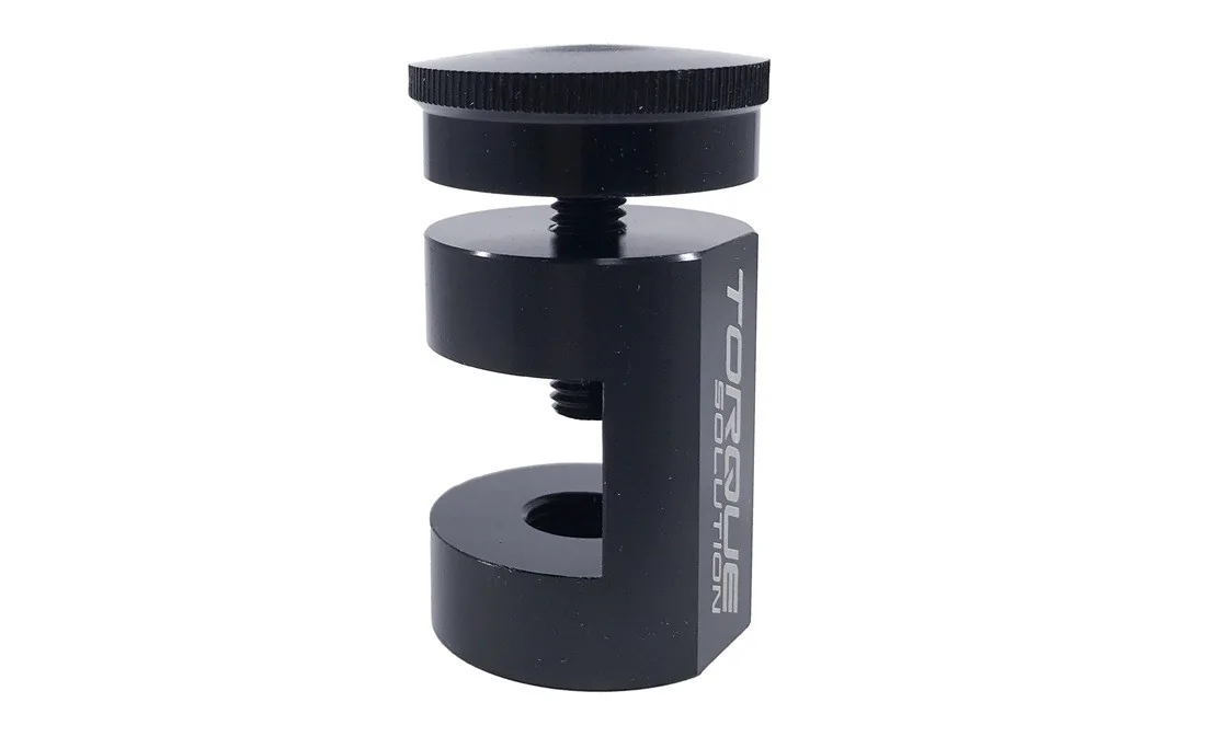

He wants to use this type of gap tool

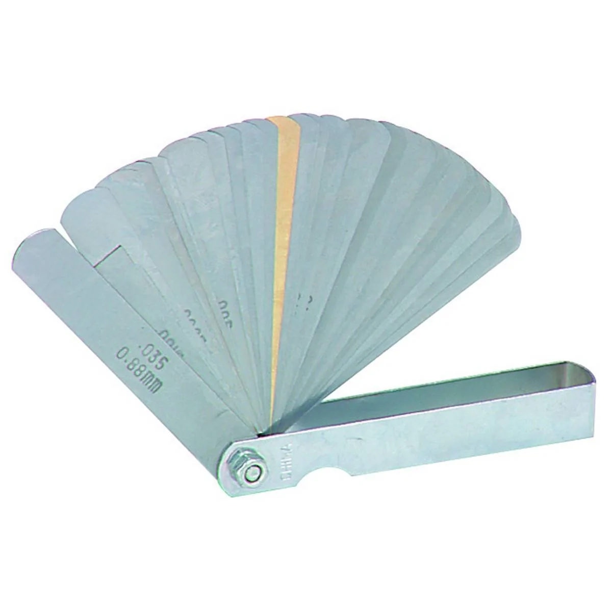

Been using this combo to measure and gap plugs for the last 30 years. Takes like 30 seconds per plug.
I have this exact tool. It's great quality. I have one problem with the design. The threads are coarse so with a very slight turn of the knurled knob results in a drastic gap change. This needs to be redesigned with fine threads to offer more control when adjusting plug gaps.
