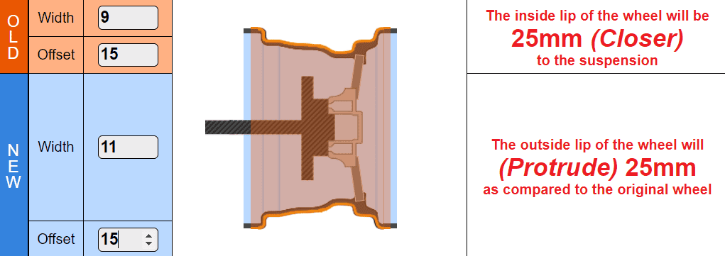

Like @EFI noted, it depends on the width of the wheel.
A 9-inch wide wheel with +15mm offset sits completely different than an 11-inch wide wheel with +15mm offset. Here's a visual:

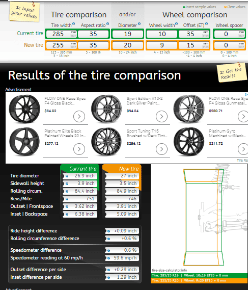

I get it.. specifically I'm looking at a 20x9 with 15 offset

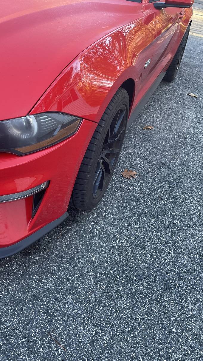

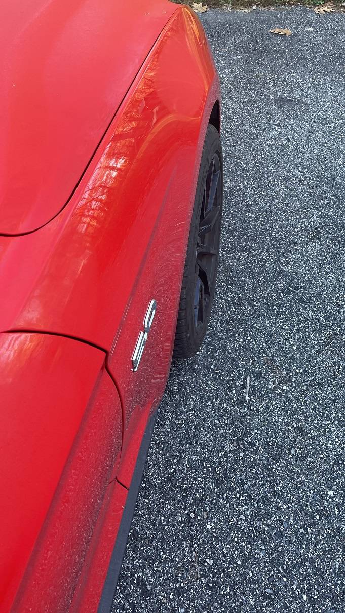

You'll be fine. For reference my wheels below are 10" +34 offset and with the factory -1* camber. Your 9" +15 offset will sit 6mm further out than mine so just about flush with the fender.

so it will stick out 0.3 inches more... 7 mm.... seems like it could work fine

I hate quoting images because it just janks up the thread imo, so I won't. What website did you use for that wheel/tire comparison?

Even with the narrower tire, you may need to dial in some camber - too close to tell.
