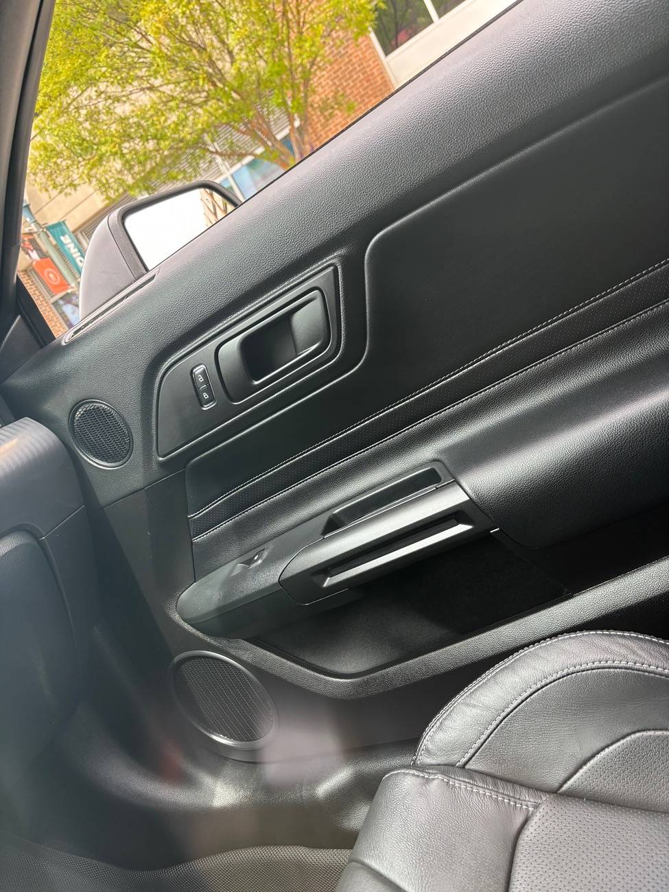

I did the black door handles from a dark horse to replace the chrome.
Handle is a direct swap and pull just requires a bit of trimming cut off the back.

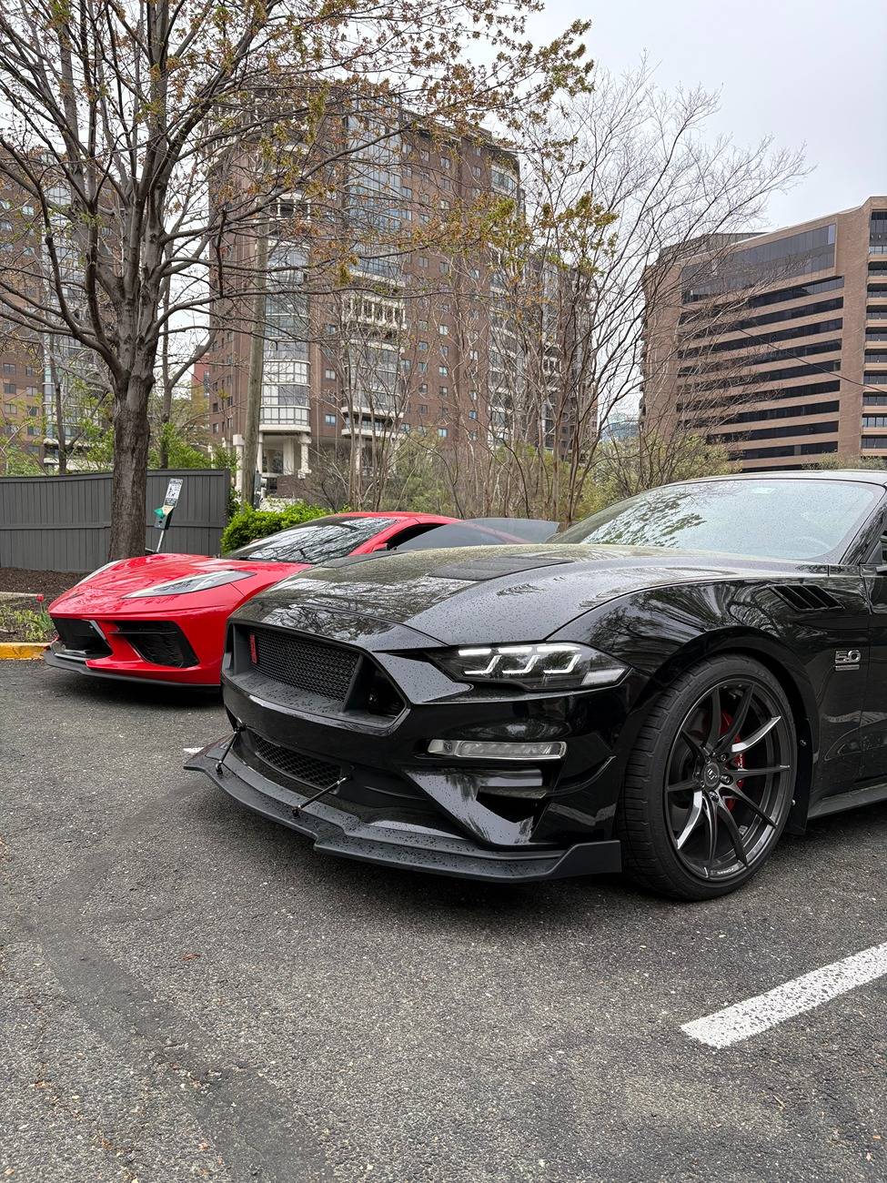

aftermarket headlights

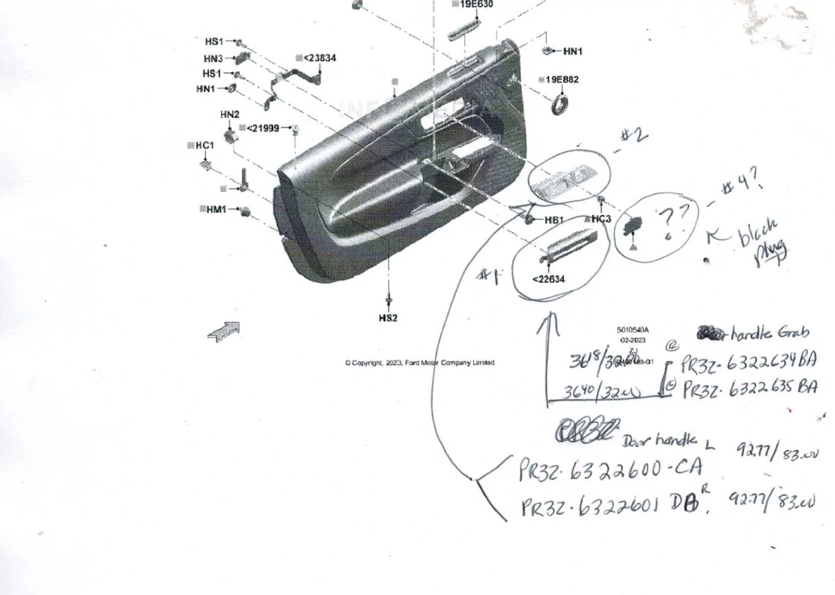

Part numbers and maybe a little explain on the cut? Please, this looks fabulous.
