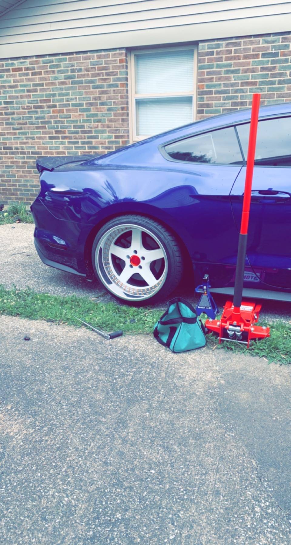

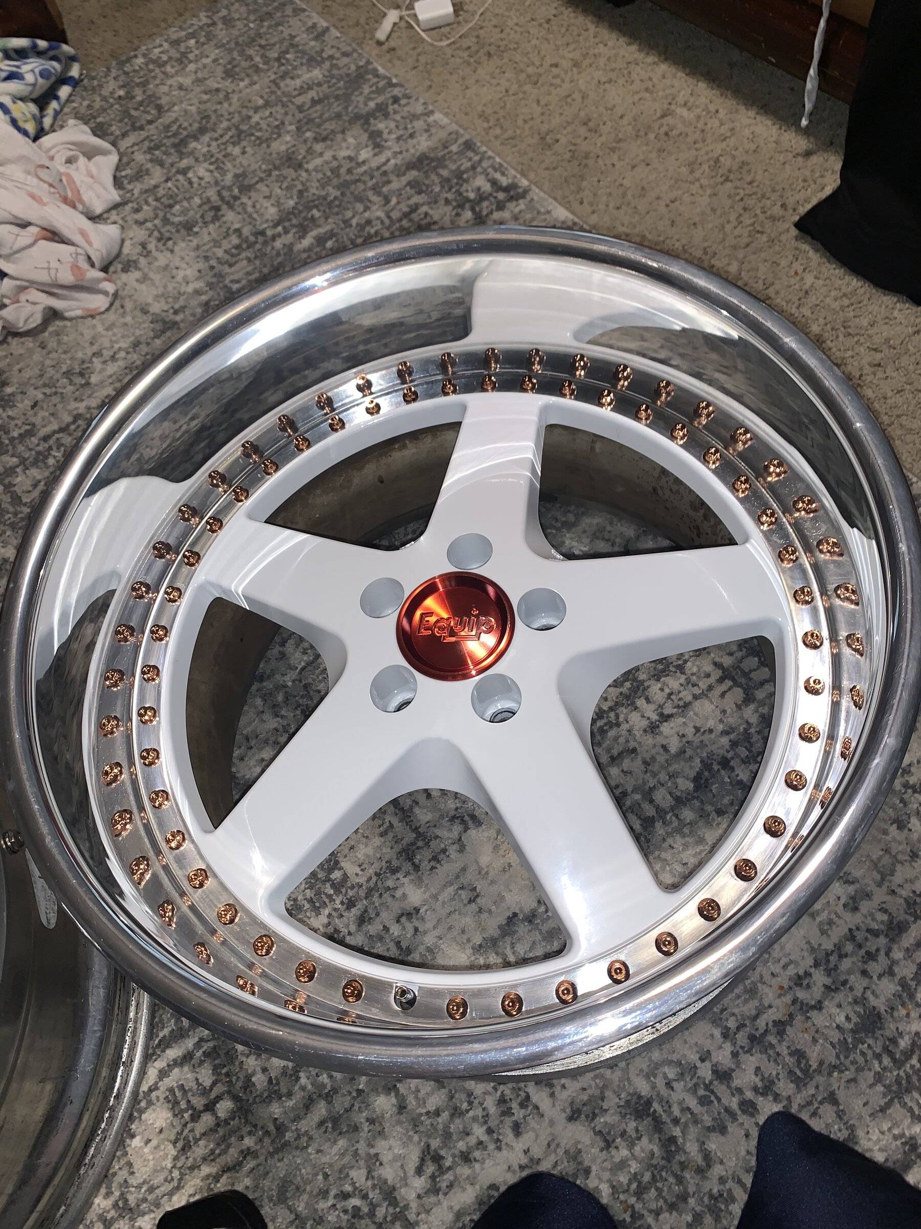

So I know it’s not everyone’s cup of tea but I’m tryna fit some 3 piece wheels I have the specs are 19x11.5 +12 235/35/19 for the front and 19x12 +12 245/35/19 for the rear. The fronts clear the breaks but when the lugs are tightened down the wheel won’t move because it hits the back of the wheel I have a small slip on spacer on it rn which is either 1/4 or 5/16 would a 10mm help get me off the brake enough for the wheel to safely spin? Any help is greatly appreciated pics of the wheels and my car are attached if anyone wants to see

Those look like a 350z or a bagged Lexus fitment..... To clarify, you understand a spacer may help clear the brakes, but with those offsets your wheel/tire will be outside the fender.

you can buy concentric spacers for cheap from CJ Pony parts. Like $25 for a pair in 12mm and a little more for 20 and 25mm. Are you TRYING to roll the tire off the bead in the corners?

Lol of I understand I’m going big camber or widebody
These wheels are made to accommodate stretch

don't they make "spinner" wheels that have an external disk? So you get the naked disk look without trying to throw a bead? And no, your rims have no provisions that I can see to keep the bead attached in any meaningful fashion.
