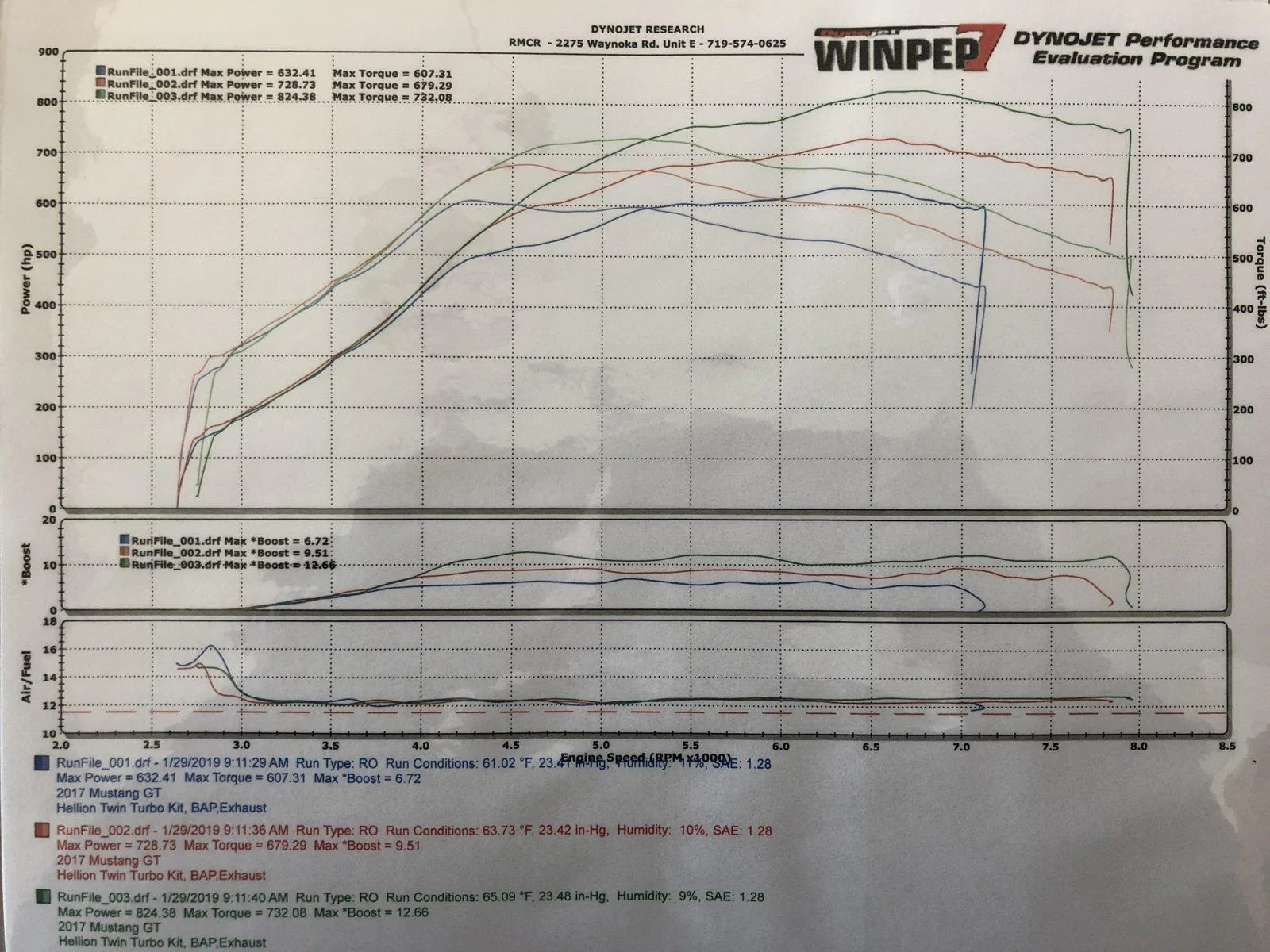

Only had the car to the track for a handful of passes. Still need to get the car launching harder. Car goes mid 10’s@136mph at 7000’+ DA on a 1.9 60ft. 20” Toyo R888 leaving with no boost, 4050lbs with driver. Has a bunch more in it once I get it launching. Shifts are 7300-7600 rpm.
Not a happy camper at the moment however. Only 700 miles on the kit, 8 passes and 3 dyno pulls and one of my turbos just failed while street driving. Sending both back to precision under warranty but am really disappointed that a turbo that hasn’t even been pushed would fail already. Not to mention the compressor wheel ate into the he housing and sent metal powder all through my motor.

At high elevation(23.4inHg) a NA or supercharged car would be missing 3PSI in their manifold compared to if they were closer to sea level, as they are totally dependant on the atmospheric pressure. Hence they would get the correction factor. A turbo's waste gate is based off getting the manifold to a certain pressure no matter the atmospheric conditions. All that matters is the boost controller or spring pressure. The turbos just spin to a higher RPM and that missing 3PSI is easily made up for mechanically. When the correction factor is applied, its making up for air that was never missing. So the dyno numbers can be 75-100hp higher than what they really are.
When you go up in elevation, turbo cars loose less HP when compared to NA/ SC cars, they don't start to make more power than they did at sea level like the correction factor indicates. You also need to factor in how fast you have your turbo spinning to maintain the airflow, they can over spin and blow up easier at higher elevations.
