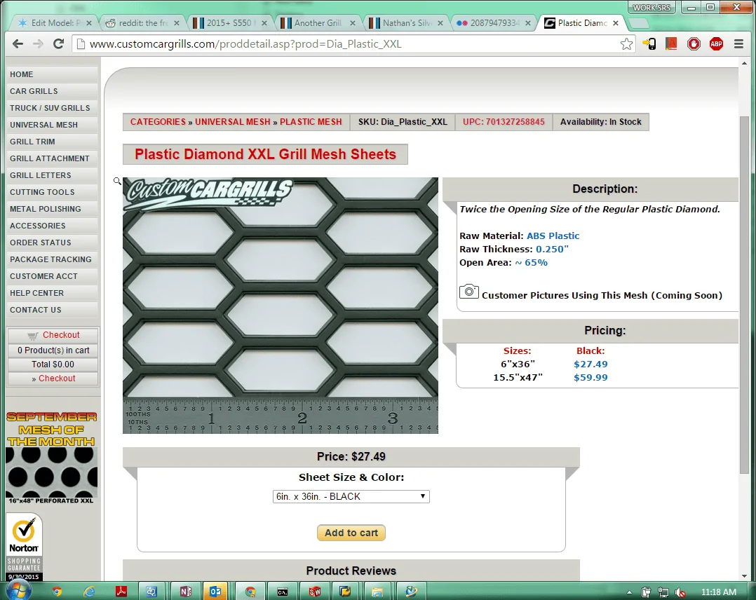

I'll be finishing up another set using a slightly larger plastic mesh this week - the XXL diamond mesh:
In for pics of the larger mesh.. BTW, how much of the product did you have to buy in order to cover the entire grill opening, and have you completed the lower grill as well?
