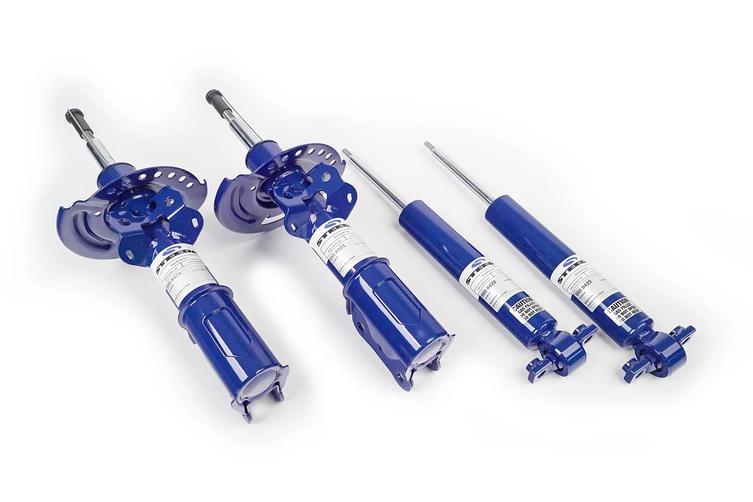

You will be extremely happy with the Steeda Pro-Active shocks or dampers! Several PP1 owners have switched over with positive results. This is by experience, not opinions by people with no experience with this set up!
Steeda Tech
https://www.steeda.com/steeda-555-8423-s550-front-rear-shocks-struts

hey Steeda - thanks for the suggestion. Do you mind pointing me to their feedback (or sharing some you’ve received)? I did a bit of digging and am coming up with feedback on the fixed Proactions, not the adjustable.

I certainly will on Monday. Matt Henschke at our GA office and Rod Williamson In our FL office have customers that have done the upgrade. Send me a pm with your contact info and I will have them reach out to you on Monday with your request.

But to answer your question—yes, you can get the Mustang’s ride better and less bouncy. The adjustable Steeda dampers, which are Koni made, were tuned for a better ride in comparison to the Koni yellows and are your best bet in my opinion. Pair these up with your stock springs and you’ll be good to go.
