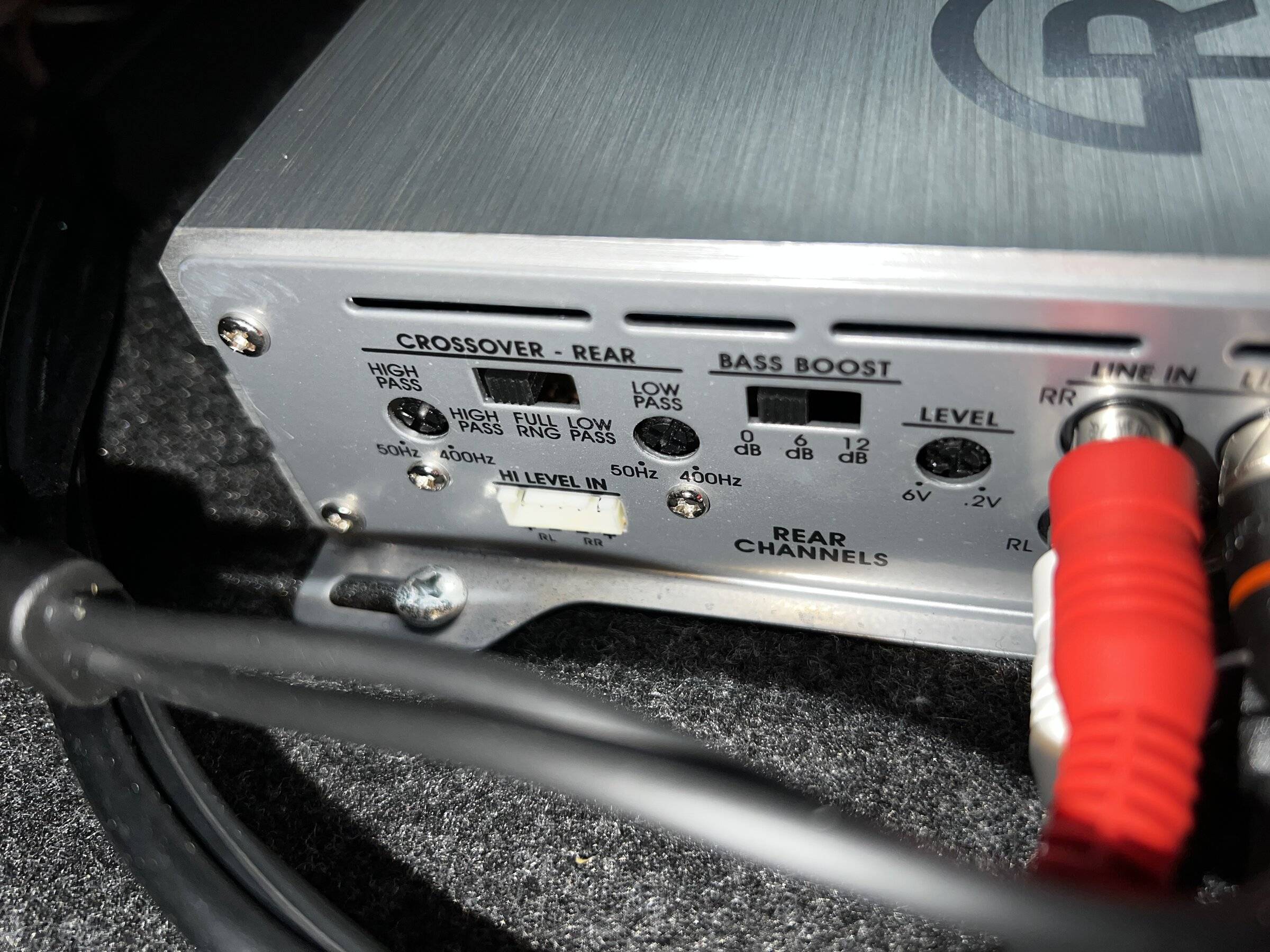

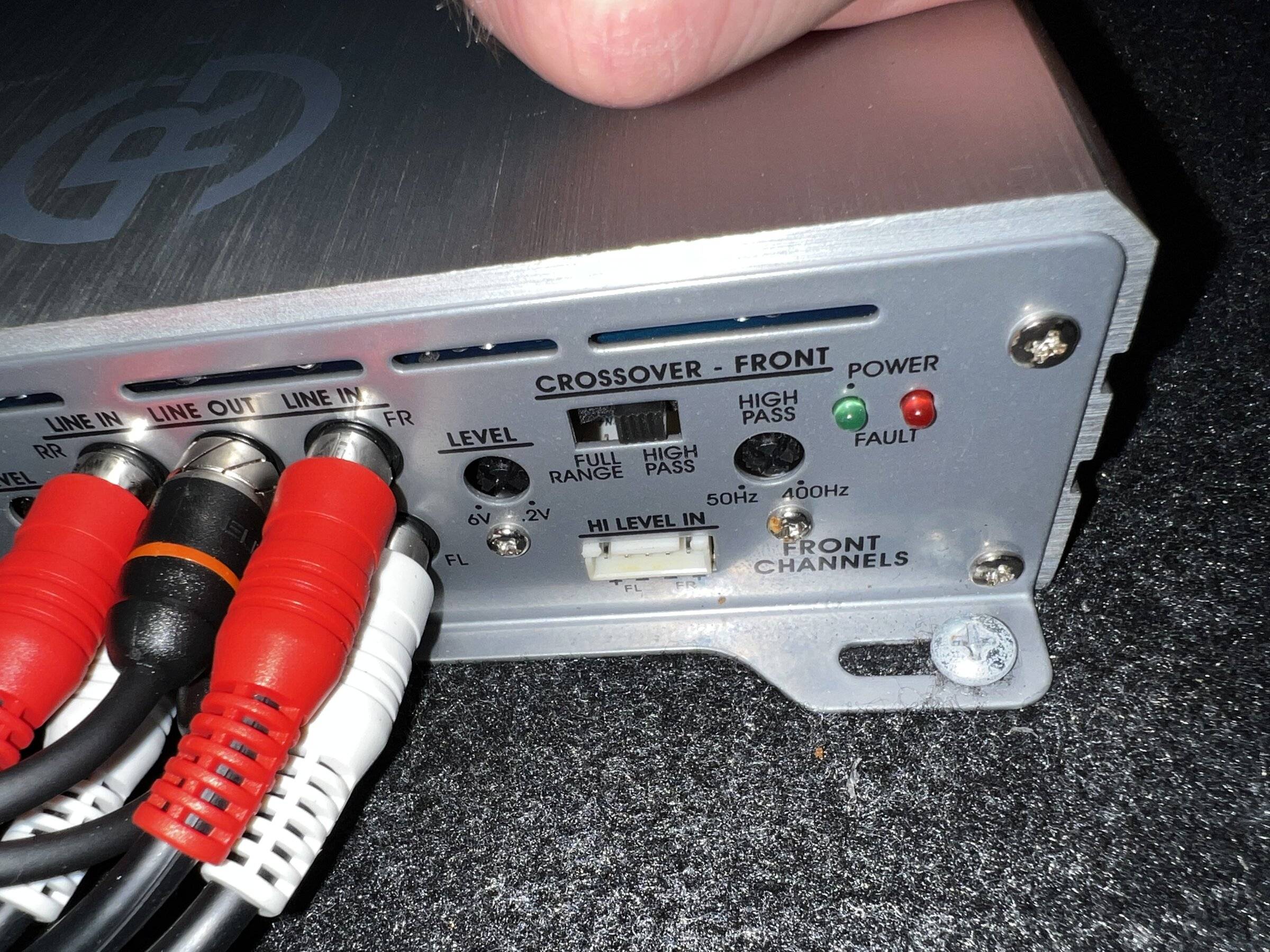

Here’s the amp and settings

Ok. Now we are getting somewhere (I hope) :wink:
Your head unit is feeding the amp a signal, maxing out around 1V-1.5V. The Ford head unit can output a clean 2.7V, but regardless, you have to set the input levels on the amp so that around 1.2V output from your head unit the amp is at or close to full output.
Where are these dials set to approximately (like what clock position)? 6V is going to be less gain and 0.2V is going to be a lot of gain.

Both level knobs are about halfway from left or clockwise

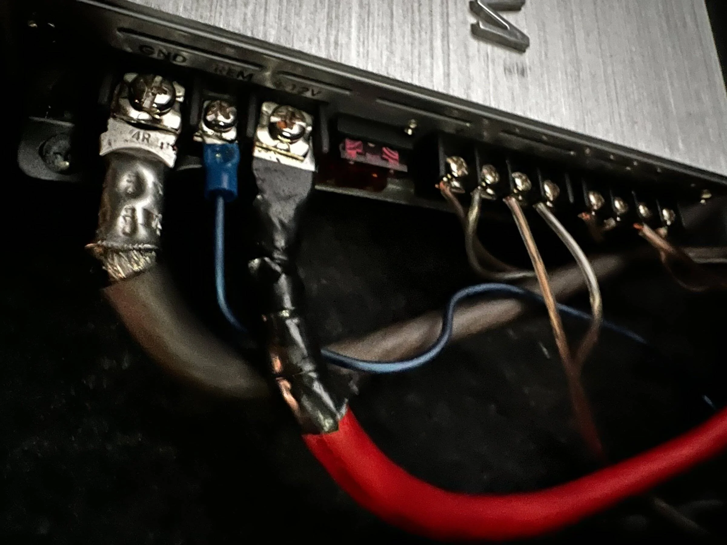

Just another tip... you should redo your wiring on the amps as one of your pictures is showing open cables without any isolation. This can potentially burn your vehicle down. So please add another layer of heatshrink or at least some isolation tape to this.

If the DSP fixes my audio quality the budget is limitless, but if it still sounds like trash and determine it’s the headunit than I’d rather put money towards the ford oem premium head unit that’s 1500.00 programmed and thank you I’ll fix that asap
