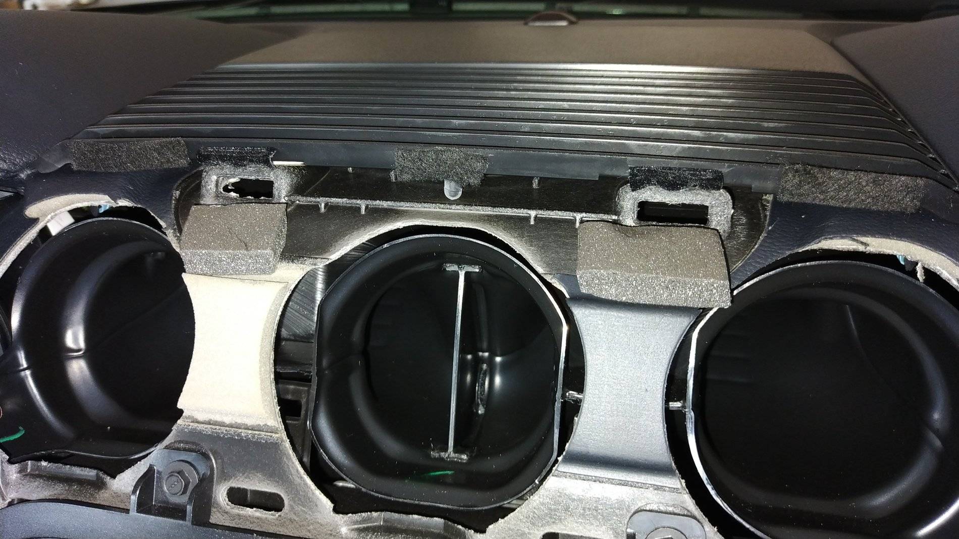

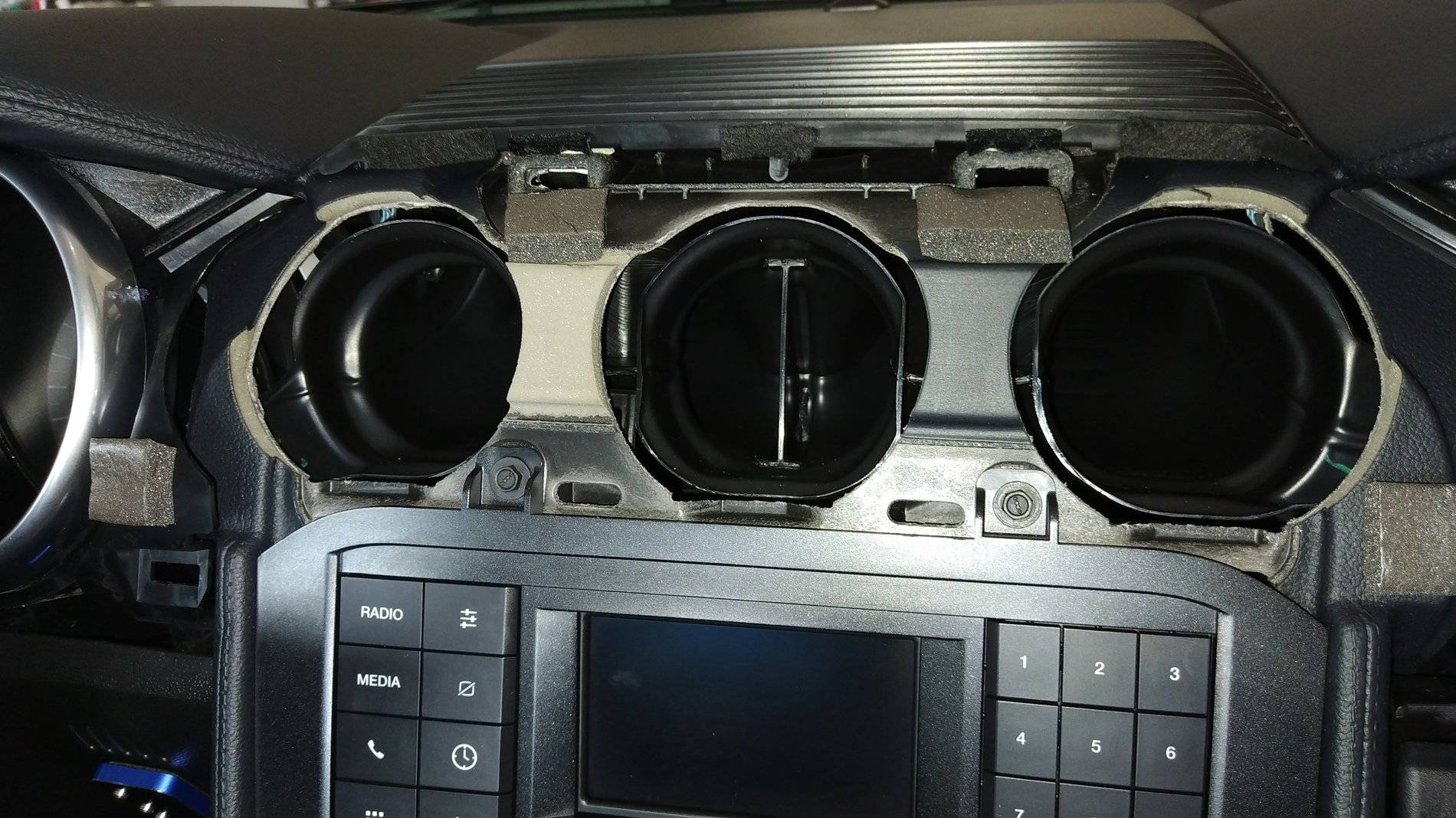

I did remove the center trim 2 weeks ago and tried by best to place the foam tape in that area and also lost few of those blue clips but luckily had those in stock from Amazon. I think I didn't do a thorough job I guess cause the trim creaks and maybe the clips are loose. I should have applied the foam in the center vents area as well. Check the picture I attached and see if I miss something. I'm afraid to remove it again and lose those clips in the dash and then they start to rattle lol.

Looks pretty good to me. If you're still hearing the same rattle as before after all this I am guessing the noise is coming from a different place.
