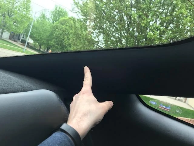

With 500 miles on her I’ve developed a pretty bad rattle at the location in the picture. It shows up on bumps at lower speeds, and then just hums along with the frequency of the car at highway speed.
Rather not have the dealer mess with it. Is there an easy/free way to see a diagram of this part so I can figure out the best way to take it off and fix the rattle inside? I poked around on the ford parts website and found the diagram there but it wasn’t really clear enough for me.
I assume it just pops out, but I’d hate to break the tabs...or screw something else up with the underlying material.

Popped it open. It’s the metal curtain airbag canister making the noise. Probably shouldn’t mess around with that too much.
/edit. There was a spot where the metal of the canister was lightly touching the frame of the car. I put some very thin fabric between the spots. Seems to be solved, and shouldn’t cause any issues.
I have a similar sound on the passenger's side. Was there a specific way to get it off or can it just be pried?
