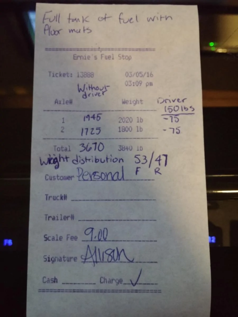

Need more, Kinda disappointed how high this is considering how much work Ive done so far. Guess I need to get back to work

Looking for some advice on what parts I could safely replace by fabbing my own with aluminum. I want to dramatically reduce my weight to around 3300lbs. suggestions on my next project would be helpful.
Parts i've already done:
front and rear crash bars (aluminum)
Hood insulation
sound tube
engine covers
cat back exhaust
Rear seat delete and seatbelts
Forged Wheels
Parts I will be purchasing:
aluminum Driveshaft
2pc floating rotors
Parts I "could" replace with aluminum components:
your suggestions I out of ideas? Pics of progress so far
