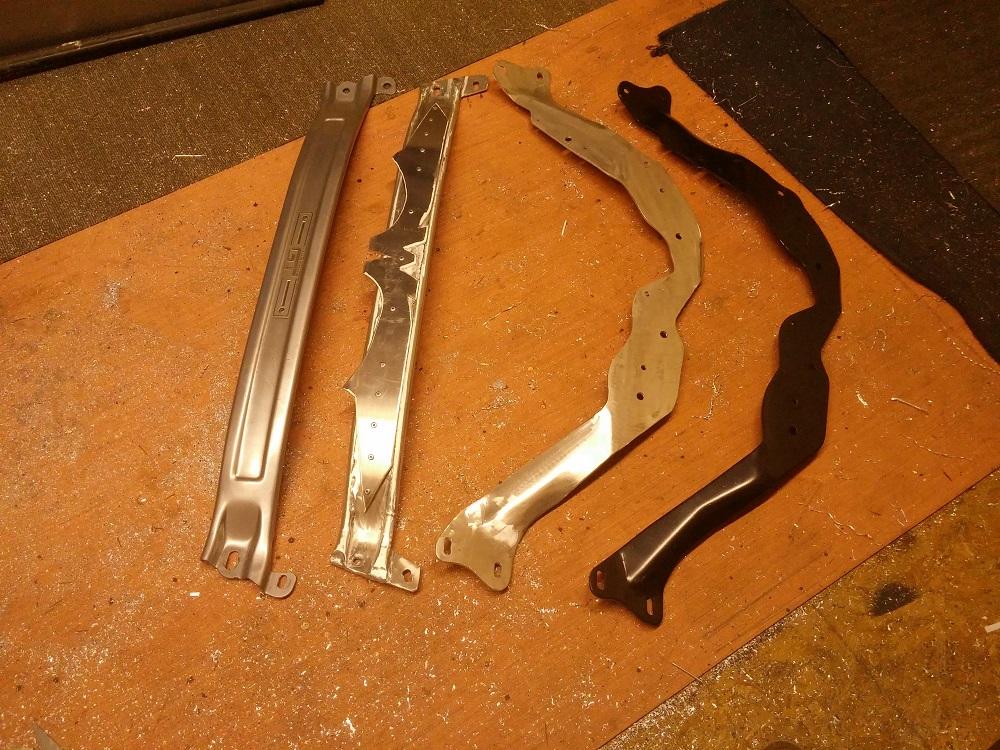

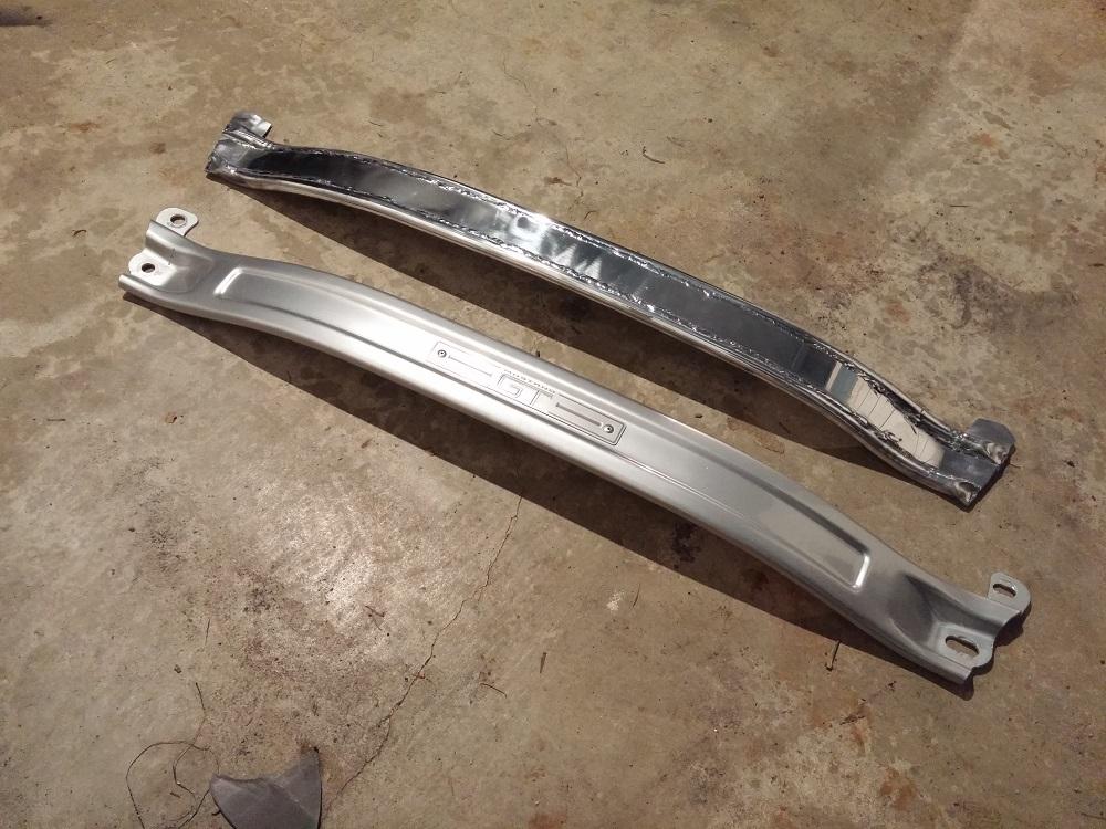

Sunday was productive. I need to grind down the welds and polish it a bit more but I got lazy and sick of sanding. Its it's actually Just about the same strength as the OEM bar. I can jump on it and it would only flex slightly, same with the OEM bar. Its only 4lbs lighter though. I had to use more aluminum than I thought to get it as strong as the OEM. It does flex a tiny bit more.
Ive decided for the radiator support i'm going to use structural rivets and glue where I would need to weld. That way heat wont weaken it and it would actually be stronger than any weld. The K member i'm going to use a solid peice of Aluminum 1/4" thick and bend it. Basically make an exact copy of the OEM

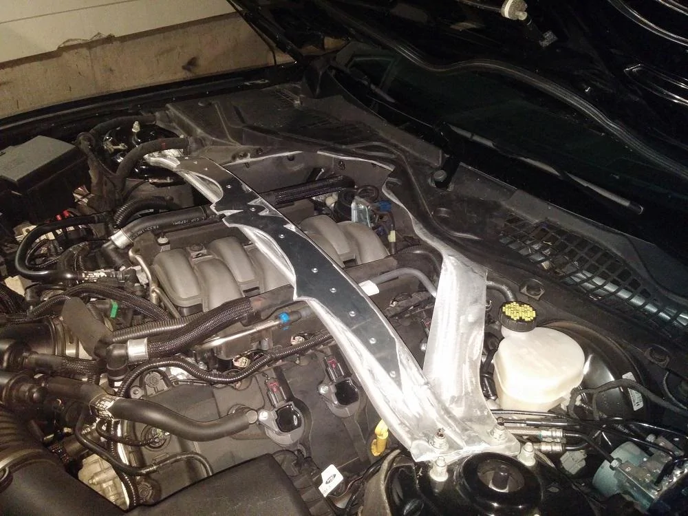

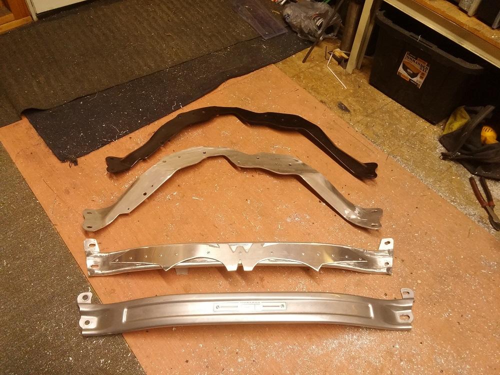

Ok So Version 2 of the Strut tower brace... IT was not strong enough and didn't help during my testing over OEM. Kz you were 100% right I had to add riveted 1/4" plate across it to stiffen it up.
Test method was used a jack under one tires and raised it until the other tire came off the ground and measured the difference. And tried again with the different braces. The K-Brace is 1 inch wider than the OEM and slightly thicker. I dropped the weight in half over OEM Braces and maintained the same rigidity and body flex.... SO these are fully functional!
