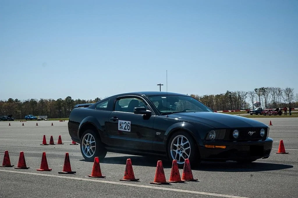

I think it was a good call to go adjustable.
And FWIW, good damping does tend to reduce your perception of how much a car's body/chassis is moving on its suspension under acceleration, braking, and cornering. Even when there's this much, it's not terribly bothersome ↓↓↓ . OE springs with Koni yellows (forget settings)
