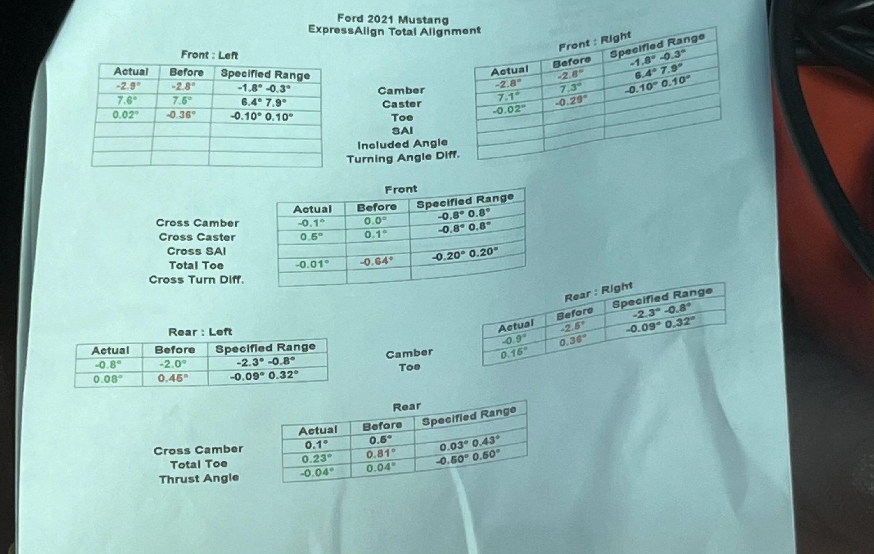

Hey All,
After lowering 1 inch and realigning, these are my settings. The tech said although the camber is in the red, it's very minimal effect on tire wear and that the camber is perfect for turning performance. I have a GT PP1 with non Mag-Ride. Based on this alignment results, i think i'll be ok without having to purchase new Camber Bolts. Any advise?

I’d probably dial in front toe to be the same on both sides but otherwise, looks good. Well more than capable for a street setup

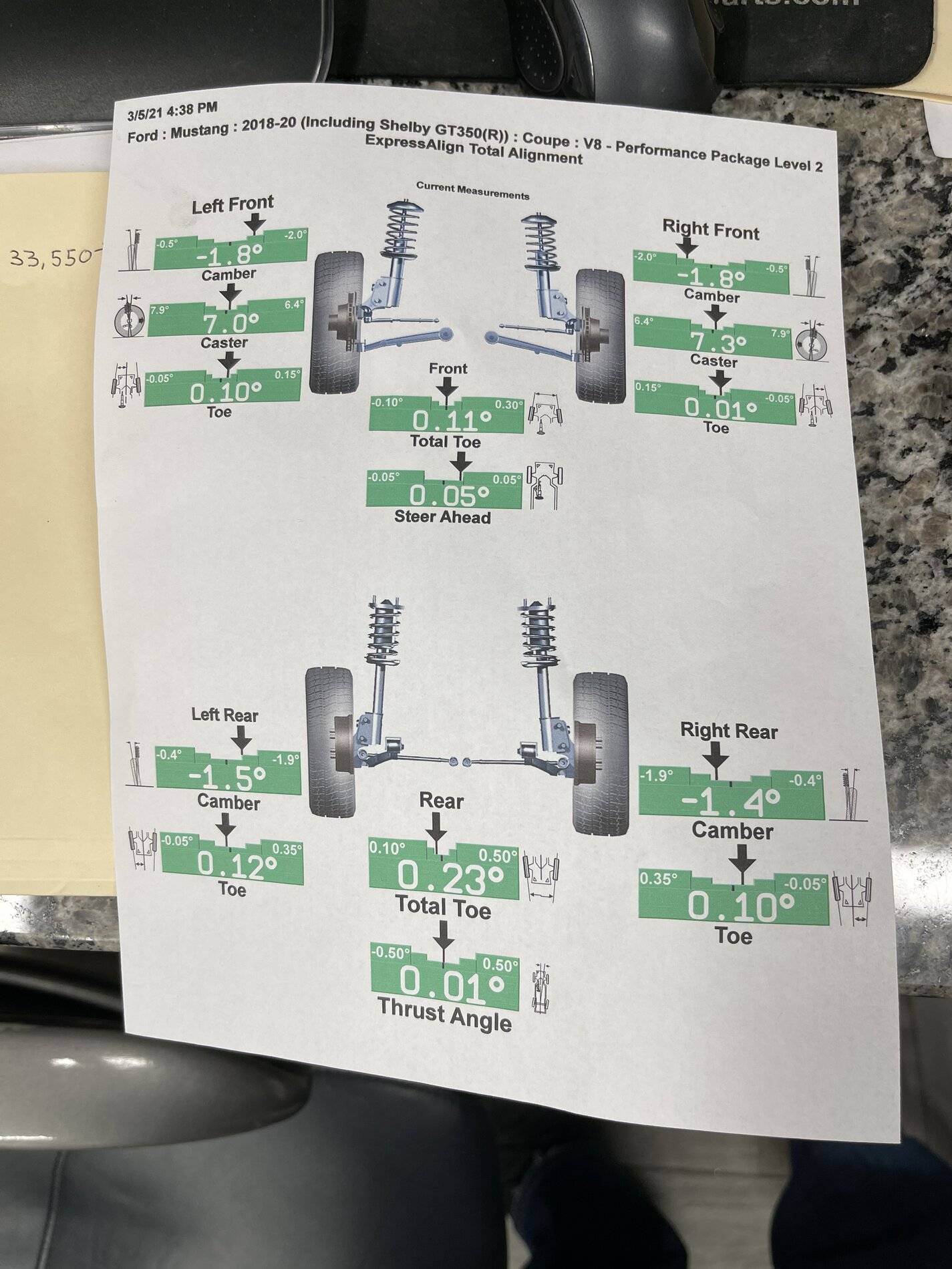

You should be fine with those specs. I have a 2020 PP2 with Steeda 1” drop springs and mine rides great with these specs attached.

Thanks and I’m a bit jealous that you got a PP2. Stopped making them for 2021 and I wasn’t in the position to get one last year.

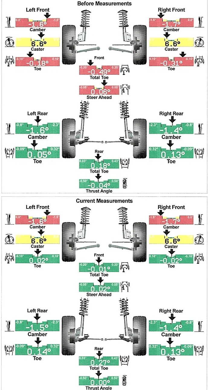

Hey Guys, sorry to revive an old thread here, but i'm on the fence here and am hoping more of you can chime in with some advise. Above i showed what my allignment specs are after lowereing. I did buy camber bolts to bring it back within spec, but not sure if i should do it. I"m more concerned with tire wear. Based on my negative camber up front at -1.7 and -1.6.....what should i do? Do you think i should put the bolts on and reallign? what are the factory specs? How much am i off? I know a few of you said i shouldn't have any problems, but just want to figure out what i should do? Thanks in advance.

I would install the Steeda roll-center correction and bumpsteer kit. You’ll get handling benefits and dial your camber back a touch.
Otherwise, just roll with what you have. -1.7 is fine for the street; so long as your toe is good, your tires will be fine.

Leave it alone. The alignment specs are great. You will have no problems with tire wear. 👍
