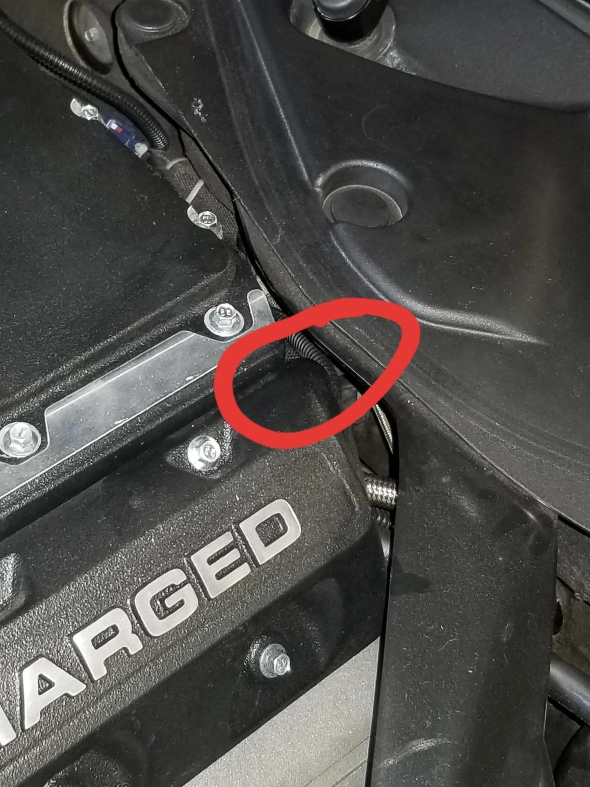

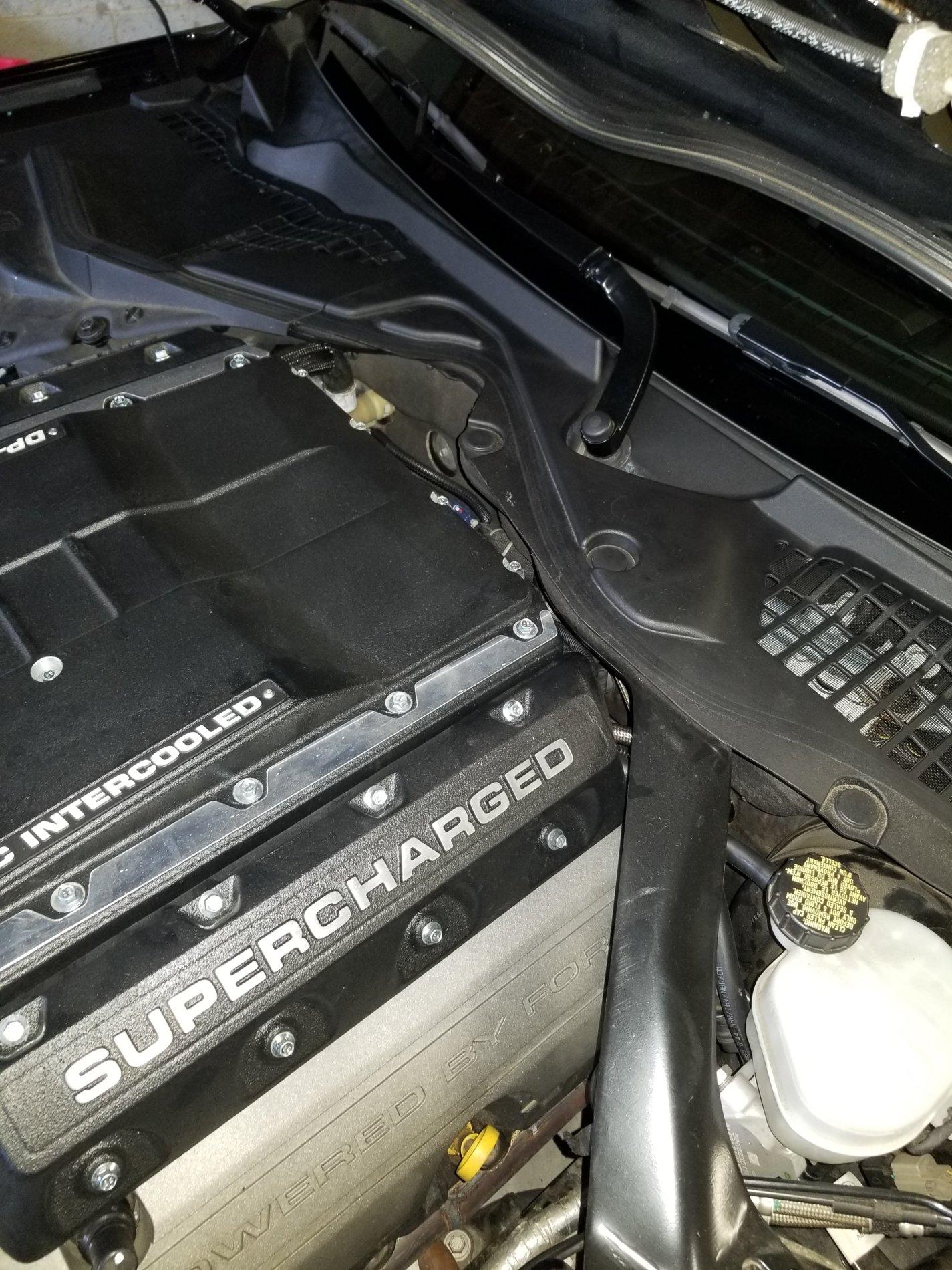

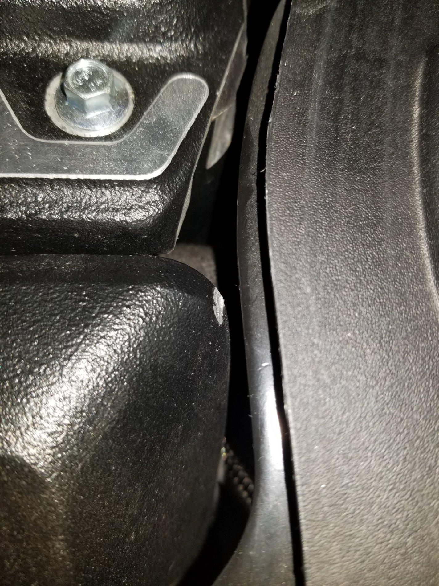

I noticed this today while checking the oil. I believe this interference was causing some false knock on shifts. When I first installed the kit I checked for clearance all over and it was tight at spots but clear. Obviously when the engine flexes in the mounts it was hitting here. One of my biggest complaints on the EB 93 tune was it felt weak after shifting hard into next gear. This week I've been practicing quick 3-4 and 4-5 shifts because I'm hopefully heading to the track next Friday and now the car feels great after each shift with no loss of power. It must of rubbed its self clear but I'll be adding some additional clearance in this spot just to be safe. As you can see from the pictures it's not noticeable unless your right on top of it. Nothing else give your setup a quick look just to make sure.:like:

can you please explain what is hitting what?

The supercharged cover is hitting the K brace.

Like CraigJ said, it's the removeable side supercharger cover hitting the k brace. It's looks like it shouldn't hit but obviously it does. I'll take another picture from a different angle later.

The instructions tell you to push the cover as far forward as possible to avoid that. I didn't bother leaving them on, they're heavy and hold heat in the fuel rails.

I did push them all the way front and mine still hit. They are heavy and hold heat. I think I'll do a side cover delete for my next mod!:idea:

Yeah mine hit a tiny bit on the corner of the passenger side so I ditched them. They look cool but I don't need a cast iron frying pan hanging off of both sides of the blower.
