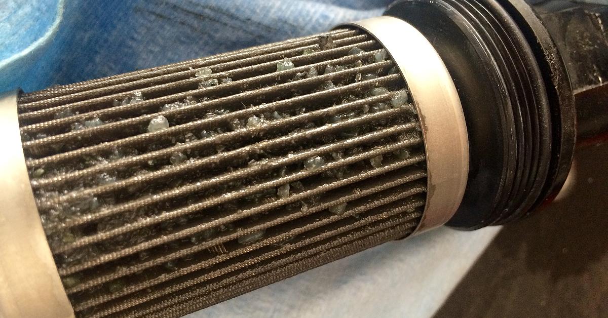

Well, in the last 7 years I have been very good about cleaning out my filters about once a month or so just as caution. As well as having the injectors cleaned at least once a year. Always warning people to keep an eye on fuel pressure, and air fuel ratio once they swap to E85.
My car has been flawless as usual, same plugs, no tune changes.
Then I got gas a week ago, and 1 day later got the fuel pressure warning.....
Here is what I found today when I pulled the filter.
The dreaded "E85 mystery goo balls"
Now I know there are allllllll sorts of theories on internal vs. external pumps, and heat in fuel vs running coolers, and additives etc. However I can run months without an issue what so ever, then magically after one fill up get this. (without any change to my set up) So, who knows what really causes it...all I know is that if you run E85, make sure to keep your eye on that AFR, and FUEL pressure. :)
PS: So I run a $4000 ecu on my car, that I have programed in many safety functions, to shut down the car if issues arise that could hurt the motor. (Such as AFR ratio per psi, fuel pressure monitor, etc) All of these functions can set codes, flash a light, or shut the motor down if something is bad enough.... (aka, fuel pressure dropping) So no motor damage happened, just a warning, and some down time to clean everything.
How do you clean your filter after removal? Is there a disolvent for this e85 issue?
Thanks!
Thanks!
Depends on the filter type. Hopefully your AREN'T using a paper filter. They can be cleaned just by soaking in regular gasoline. Also why it's recommended on the flex fuel tunes to run a tank of gasoline every few tanks.

anyone checked their Sai li kit?
yonson
May 21, 2014
83
127.0.0.1
'21 A10 401A, '16 RCSB 5.0
This is part of the reason why I run a full tank of 93 for every 3 or so tanks of E85...
Thanks, I actually have a Fore Return Fuel system with 128mm microglass ssd filter.

Ive been running E85 since 2012 moving here to vegas and never had this or seen it, none of the cars that we did FF on had the problem either. Wonder if its location? Weather? I ran straight e85 in one of my cars for 3 years straight never filling up with pump and when i parted that out and swapped pumps with the guy that bought my FI setup it was fine.. damn

I run a tank of 93 once a month to prevent this.

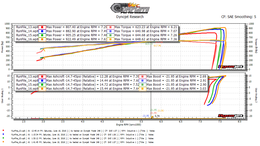

Is that on the f1a94? Stock engine? POWER
E85 is the shit
Yup F1A-94, stock engine and on wastegate at 15psi it made 922whp.

The theory is the gunk comes from converting cars with some miles on them over to e85 and the gunk is residue from cleaning effects of alcohol. My injectors I bought from my buddy had around 8k e85 miles on them and looked brand new, but they came out of his brand new e85 only car.
