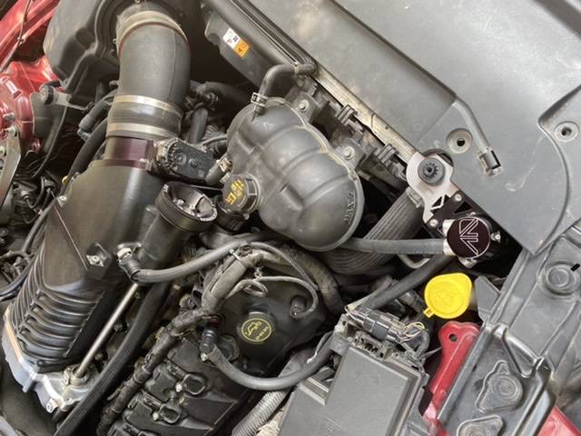

also, does your oil separator fit with a Whipple?
