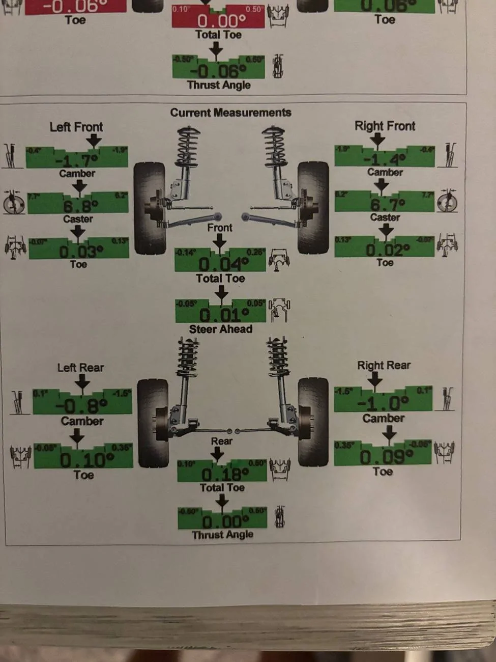

17GT350
Sep 25, 2018
43
Fayetteville, NC
Will
2017 Ford Mustang Shelby GT350
You can go with more camber than the R specs if you like, they're still on the conservative side. Are these the numbers you're using?
GT350R (with OEM plates)
Front
Camber -2.20°
Caster 6.92°
Toe - Total 0.10° toe in
Rear
Camber -1.60°
Toe - Total 0.30° toe in
The toe is fine, and caster is generally not adjustable, so we're left with camber, which is only adjustable in the front if you have camber plates, do you?
For corner carving, if you can handle a neutral balanced RWD car and don't need it conservatively tuned for understeer, then you should try for a front/rear bias of 0.5 degrees or more (more camber on the front than the rear, like the above GT350R specs with a +0.6 degree F bias). For a more stable understeering car, OEMs will flip that and tune it for more rear camber than front (as on the GTs and GT350 non-R). You could run 2.4/1.8, 2.6/2.0, etc... You can go more than 0.5 bias to the front (like 3.0/2.0) but I would try to keep it at least +F0.5. The front limit with camber plates (without modifying your strut tower holes) would be ~2.6 or so.
Don't worry, daily tire wear will be fine IF you maintain your toe regularly and keep it close to 0-0.05 in per side on the front.
Toe kills tires, not camber. Generally you can think of toe determining how fast a tire will wear and camber affects where it will wear. If you're tracking the car you need a bunch of negative camber to keep the outside shoulders from wearing, while on the street that camber will show up on the inside shoulders, but how fast it wears on the inside when daily driving is heavily influenced by your toe. If your dynamic toe is zero (i.e. your toe with road force deflecting the bushings and all that), your tires will still last a very long time because while they're tilted, they're still rolling straight and not scrubbing along as they go. The OEM specs of 0.05 toe in per side are about right to get dynamic toe of very close to zero.
The other issue is tire construction, so I'll just call out the Michelin MPSS and MP4S for bad inside edge wear patterns. No matter what you do or what alignment you run, they always seem to wear through on the inside edge first at around 20k miles. Chasing conservative camber settings won't change that. Other tires (and other models of Michelin tires) won't have that issue unless your toe settings are off, but its routine for the MPSS/MP4S.
What do you think of these adjustments for the street?
