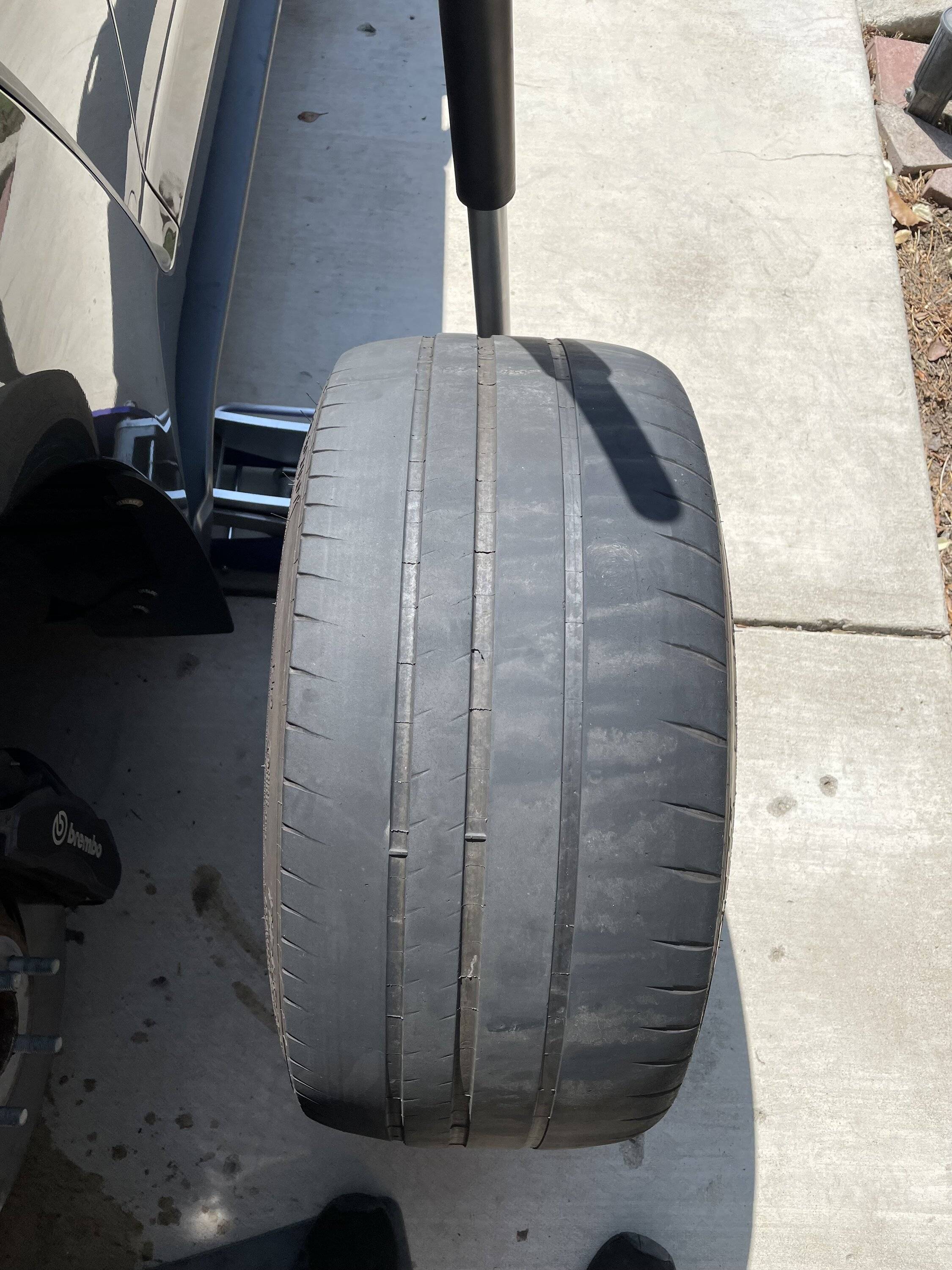

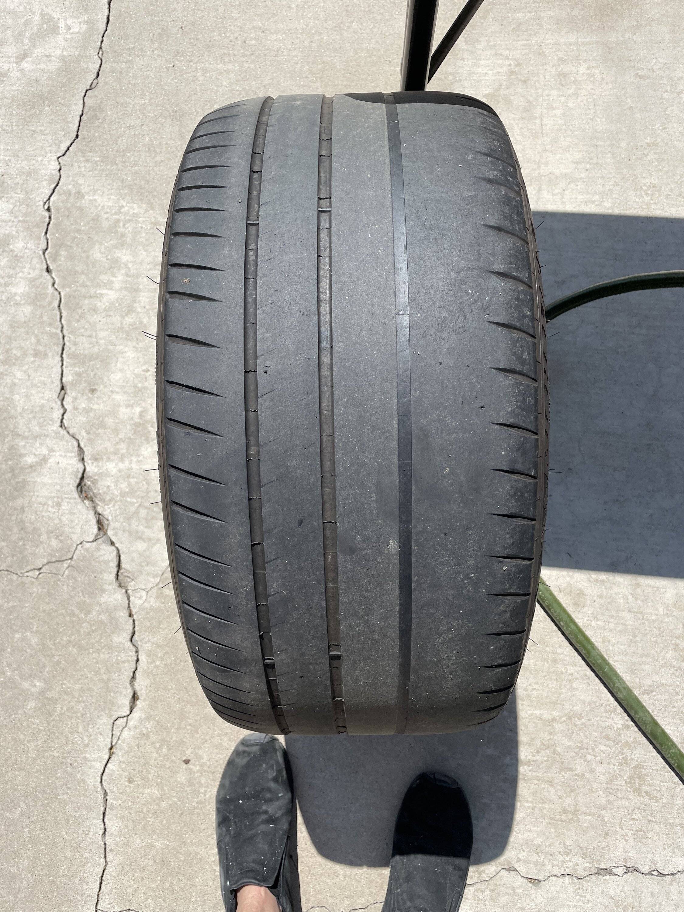

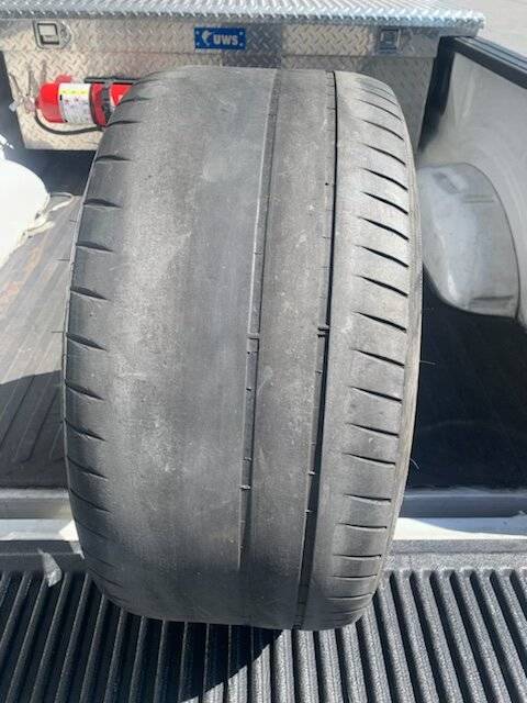

Any pictures of your tires? I have 10.4K on mine and this was last weeks rotation pictures. Both sides look the same.

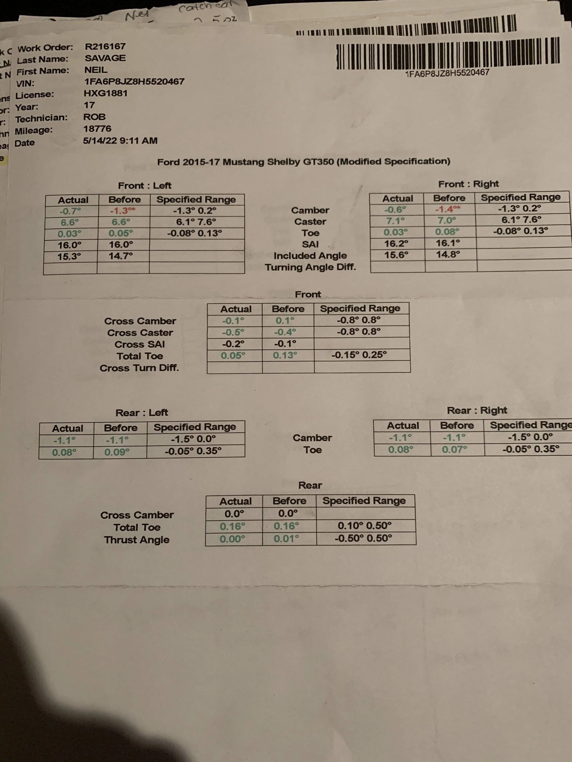

I have a ‘17 and my tires were toast after 12,500 miles. Since replacing the tires I have been gradually adjusting the front alignment to gain more life out of my tires with slightly reduced front end feel. The last alignment which is pictured below, required camber bolts to be installed to achieve the desired settings. The tires now are at 8000 miles and appear to be evenly worn across the thread.

Both sides are the same so as you can see not good lol. Just spirited street/mountain driving and this is at 8,500 as I said before which is why I thought different alignment. @460Fred

Neal...that's a really good alignment; someone took their time to do a good job, especially to dial in that detail on the rear.
One clarification though...on the front camber you were at -1.3° (stock) and decided you wanted to bring that out some? You could have left that in with little to no detriment to tire wear and retained some handling performance. Doubt (actually I don't doubt, I know) i would have touched that being that good on both sides. But you still ended up with a good job.

I’ve learned a lot about alignment since I discovered my ruined front tires a couple years ago. I believe most of the wear was due to the toe and not the camber. I purchased a three year unlimited alignment plan so I could mess around with different settings and see what works best. I don’t track the car so I’m not overly concerned about a slight loss of handling.
