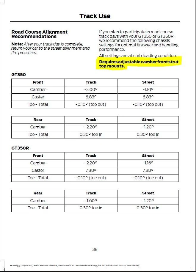

I have seen some specs for the GT350 alignment but what throws me off is the toe. It looks like ford wants -0.5 toe for street or track? It shows in the supplemental owners guide toe-total -0.10 toe out.
I plan on running -1.12 camber front and -1.2 rear camber and +0.15 toe in for the rear as per ford spec. I just find it odd that they want -.10 toe out in the front. Makes me feel like the tires are gonna shred lol

Do you have the Handling Package (Adjustable Camber Plates)? The reason I ask is because I went in to the Ford Dealer to have my alignment verified because I was reading so many accounts of people shredding tires because the factory alignment was flawed. Handed the Service Manager the page right out of the manual and asked for STREET alignment settings. When I came back the Service Manager said the tech circled the statement that those numbers are only applicable with the adjustable camber plates. He said the tech had verified all four wheels were aligned to street specs for non-adjustable plates (didn't provide the numbers). Just throwing that out there...

What’s the best toe setting for these cars? I’m shocked it’s asking for -0.10 toe out.
right now the car drives perfect. I’m curious to what the non adjustable strut top alignment specs are.
also I’m curious if running -1.2 camber front and -0.75 rear would help provide more oversteer?
