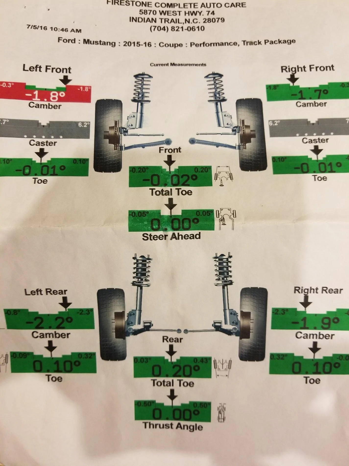

I just had the alignment done and gave them these specs that I was wanting to achieve.
Front
Camber -1.8
Toe .02
Rear
Camber -1.4
Toe .1
And you can see what they were able to achieve.
I am lowered 1" on Eibach Pro's.
I understand that limit on the front camber, but I had the car aligned a few years back and they got the fronts to -1.7. Then after that, I had BMR camber bolts installed. Why would they not be able to get more negative camber than what I had previously?
ALso, look at the toe number on the front. 0.00 per side, but an overall of 0.05? Which would make sense if each side was at 0.025. WTF is up with that?
Should I have the rear brought back down to like a -1.0 to be more in relation to the front?

yup, looks like they ignored your specs. Find a different shop. Some things you can’t teach.

They nailed your front toe specs tho. The machine wont read less than 0.05, so the fronts reading 0 means its <0.05, and the total being 0.05 means what little toe there is approximately adds up to 0.05. They got it as close as they could considering the precision of the machine.

They did get everything right except the front camber. I'm just a little confused as to why they couldn't get any more negative camber in the front, after it ALREADY had been at one point -1.7 previously. I know I got things back outta whack after installing the struts with having to remove the camber bolts and everything but why would they not be able to get it back to where it was previously?

Without camber plates u should not be able to hit -1.8° in the front. Whatever happened before was either dumb luck or a malfunctioning machine. I think they did the best they could with your setup. Get camber plates installed and you will get better numbers
No, the rear can be different than the front. I run -1.6 rear and -2 up front

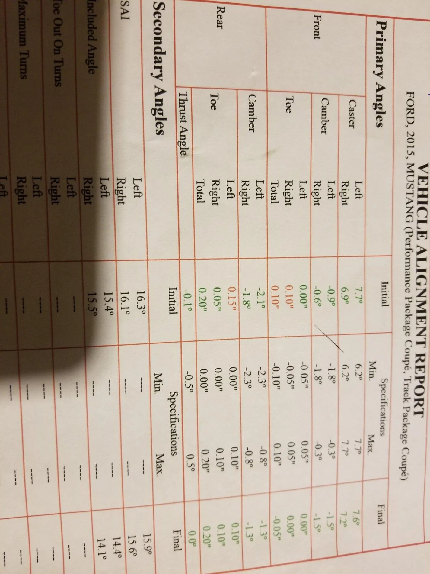

Right, and here's what it was at my last alignment which was 3 weeks before I had camber bolts installed. The guy there didn't know how to adjust the rear camber. I never had it realigned and figured it could be adjusted a bit more as BMR claims 2.5 degrees of additional adjustability.

^That's not too bad. A little high on the rear camber but I bet it was real fun in the corners. Not far off from Ford's track specs.

Not exactly...your toe on each side should be the same...look at your front toe!!!!
