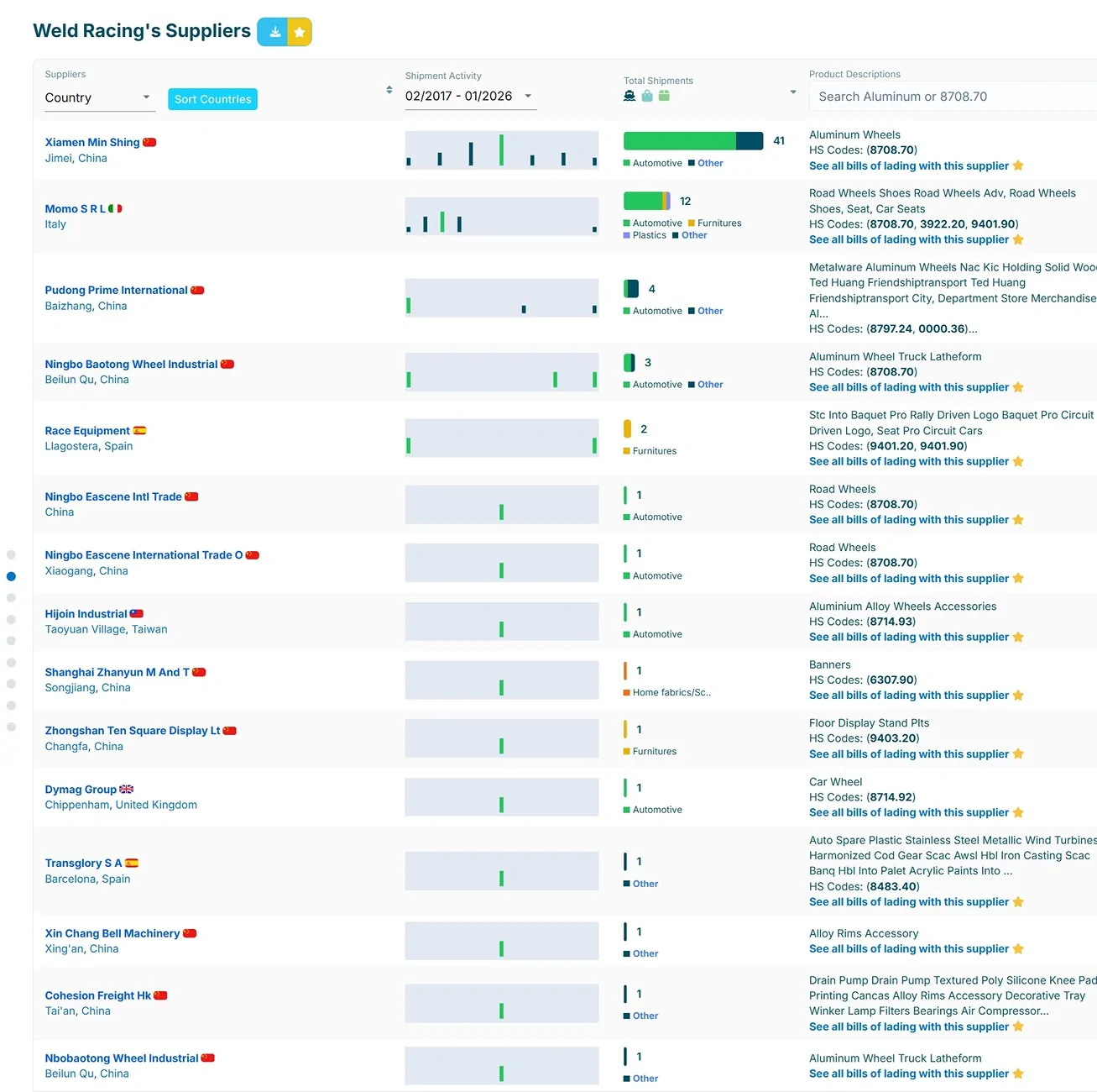

I realise this is a contentious subject but many assuming " x " brand wheels being made in Murica potentially is misplaced . Given you are thinking of Weld Racing wheel reps here is a bit of Weld Racing imports manifest , This is just information , not opinion . Clearly some of Weld Racings supply chain come out of china . Are they the wheels you buy for you drag pack mustang ? who really knows but it appears not as clear cut as some may think . I can produce these manifests for an assortment of " US " wheel companies . The list is long , DYOR and dont assume much . My living is from doing research , i am fact and data driven , no opinions . Good luck to all . Probably some wheels you can buy from Alibaba are junk but some will be from the same factory built to the same specs you pay 3 times the price for locally . Some Alibaba wheel companies build wheels for prestige manufacturer cars worldwide , i suggest this is an important factor if you want to find some Alibaba wheels . DYOR or just buy locally sold wheels .

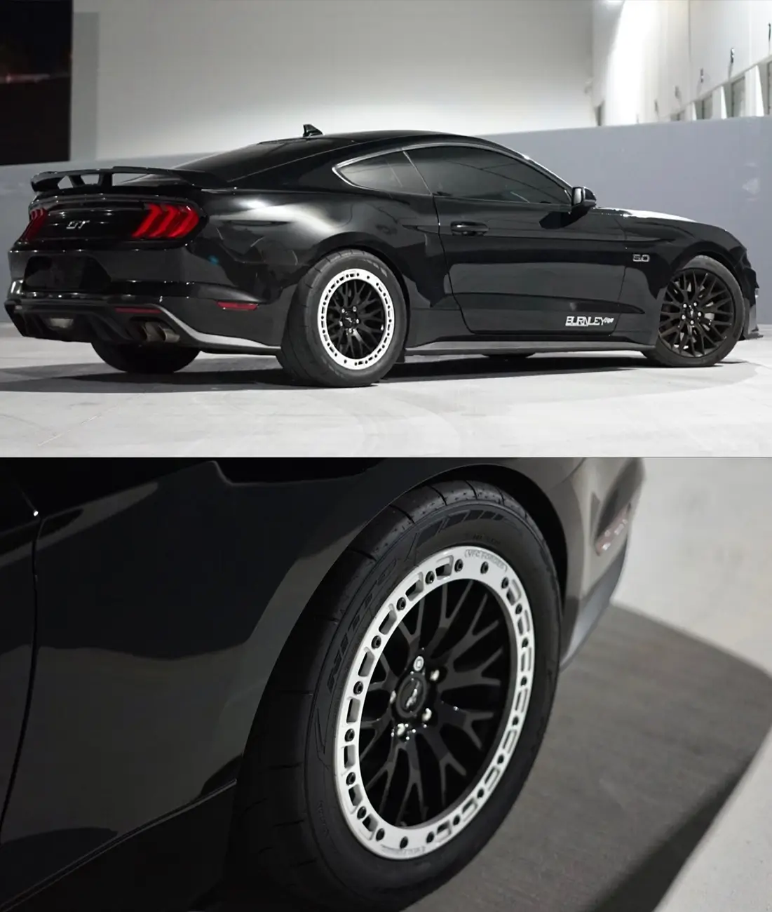

I have used a company called JOVA wheels 3 times now and on average you're spending about $400 per wheel delivered. You get full customizastion, design offset, width, color they email back and forth several times with renders to verify you are getting what you want, The process is not quick it usually takes 2-3 months from start to receiving the wheels. I am not worried about weight as I don't use these at the track, the look great for daily driving. I am working through a set right now for my Mustang but here is a set they made me just a few months ago.

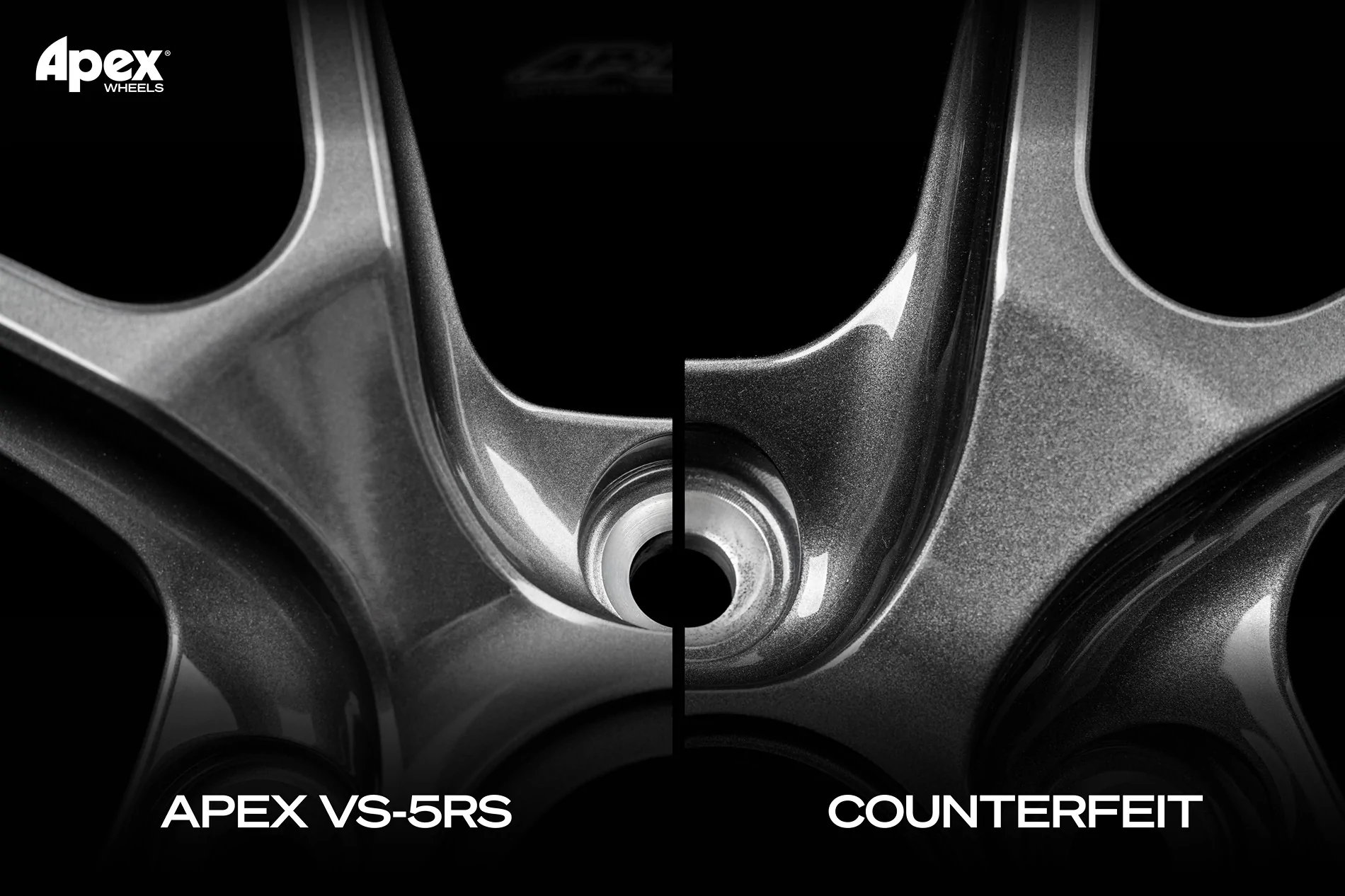

There's dozens of counterfeit wheels out there, so it's difficult to catalog all of them, but we've acquired various fakes and it's easy to see the compromises when you compare them side by side. For example, take a look at the difference in design around the lug area of these counterfeit wheels:

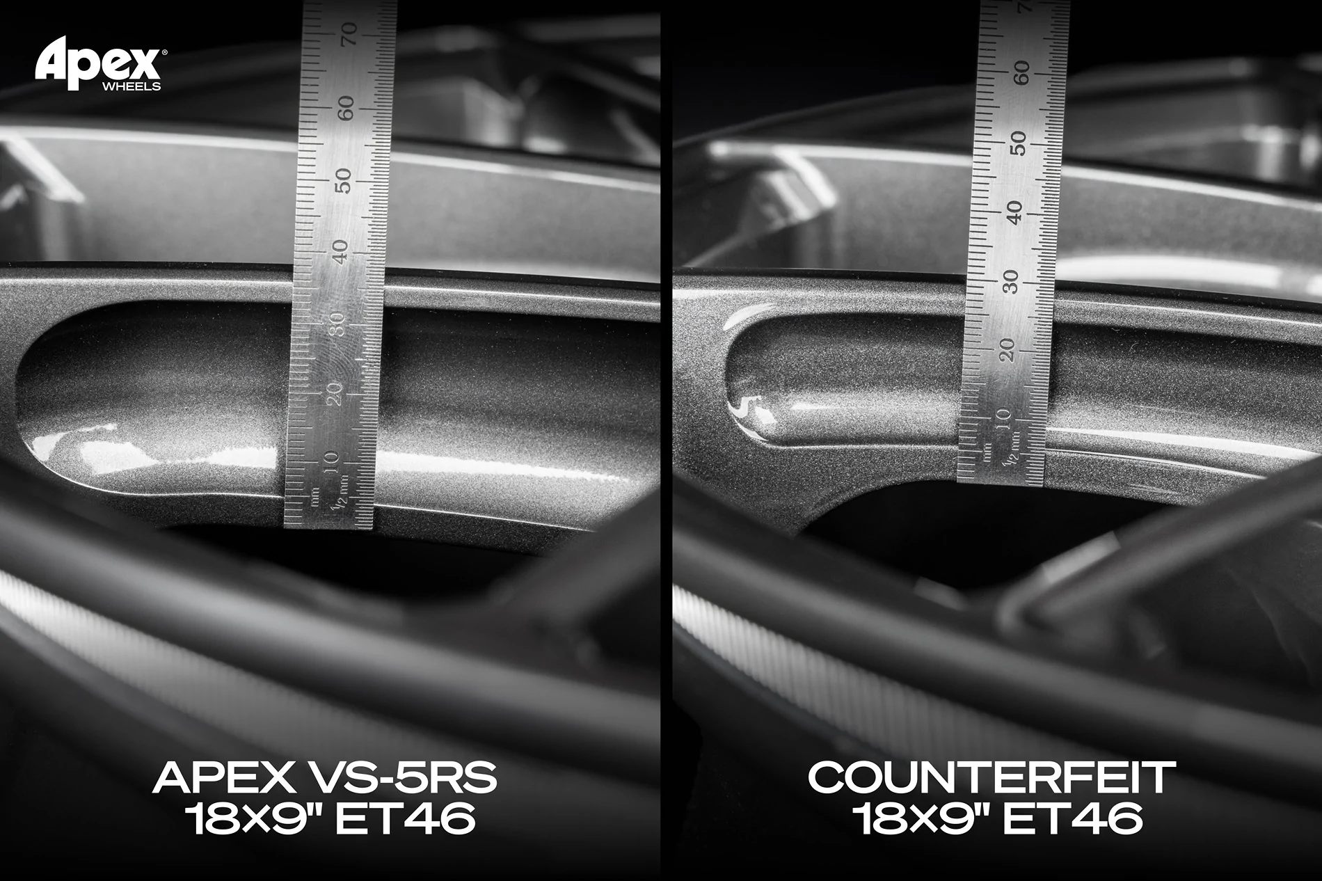

This is just one of the many, many differences between the counterfeit wheels and our wheels. The counterfeit spokes have ~25% less depth than our spokes (because they use inferior manufacturing blanks), but consumers can’t tell because they’re only judging the aesthetic similarities. That spoke depth difference alone gives up critical strength and stiffness that's important when you're pushing heavy vehicles (like a Mustang) hard.

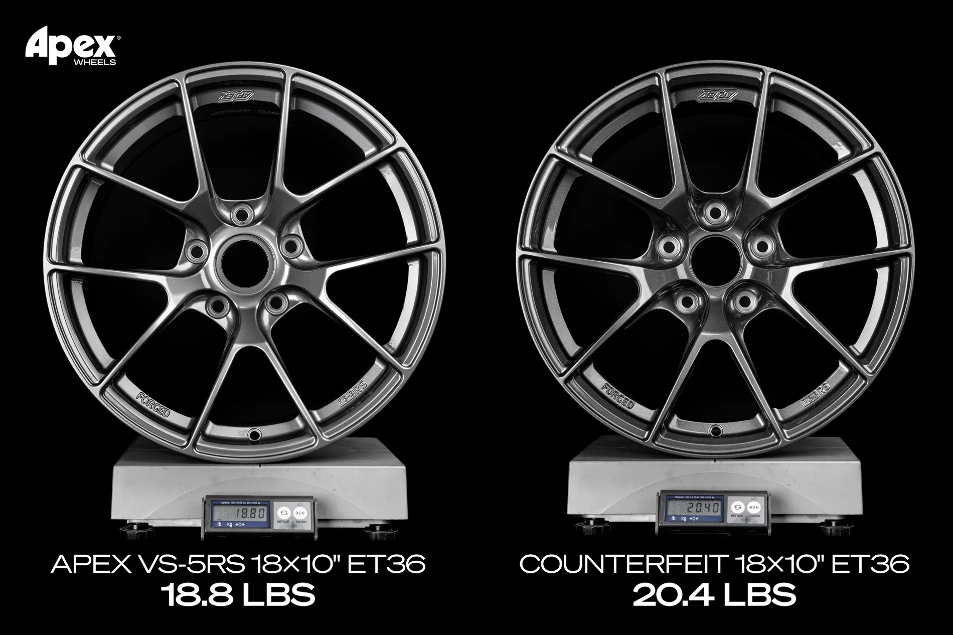

The design differences continue way deeper than that - the counterfeit barrels don't have a 0* draft angle so they won't clear as many brakes, they have standard inter lip designs instead of our Sprint Spec inner lip, the counterfeit wheels have worse side milling and rear mounting hub pocketing, the counterfeit wheels don't offer OEM center cap support - the list goes on and on.
Ultimately, what it boils down to is a wheel that simply doesn't perform to the same level as an authentic product. In our testing, we found that a counterfeit wheel in the same size as our wheel was nearly two full pounds heavier - that's unsprung weight that matters a lot, even ignoring all of the other differences listed above.

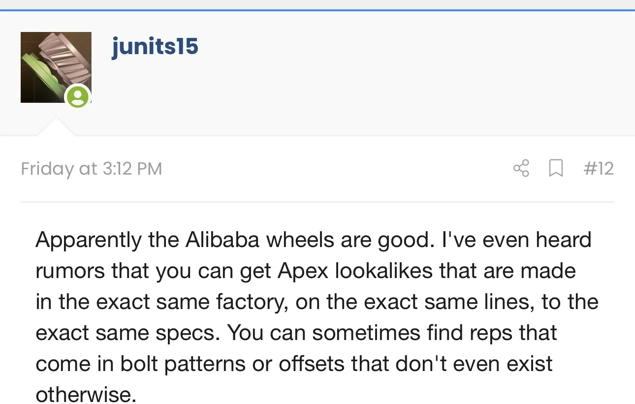

Woof, looks like a few people need to come back and offer an apology.
I won’t hold my breath!
Thanks for the informative post😎
