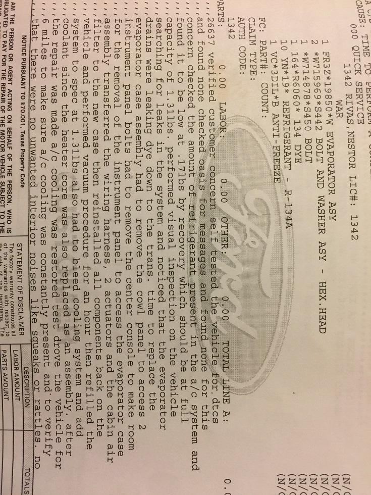

Copy of dealer invoice from the Issues section detailing the process:
