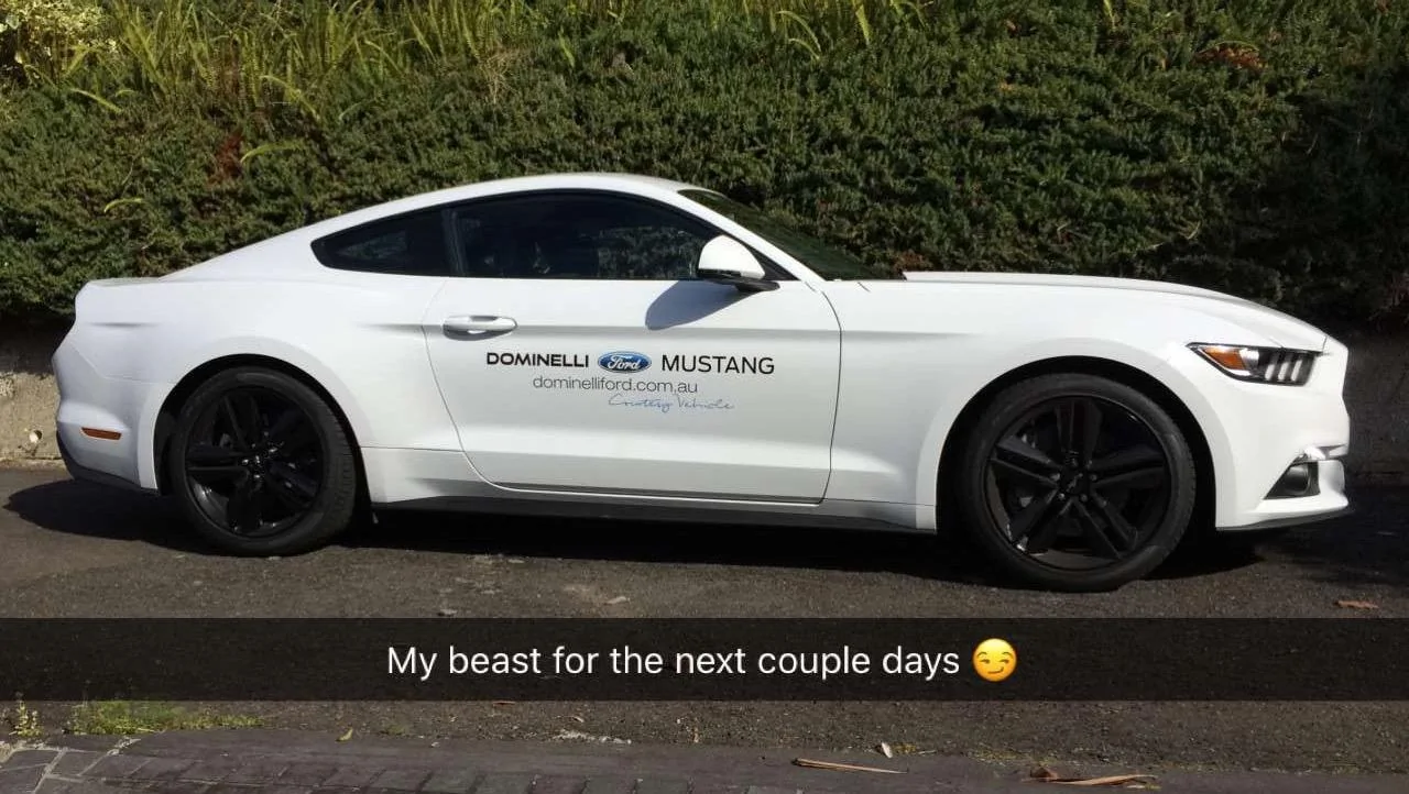

So not only do I have the pleasure of a Ford dealer pulling my car apart, i also have to drive an eco-boost for a couple of days :brokenheart:
It's a step up from the EcoSport that I was given as a loaner for a warranty issue. That particular vehicle is a blight on humanity.
By all reports it's going to be a stinking hot weekend, so you'll likely need that aircon pumping.
Not too bad, though the stickers are on the nose. I've had an EcoSport (which seemed to me to be a lifted hatchback) and a Fiesta which was also covered with stickers. Rental cars are more subtle :ninja:
