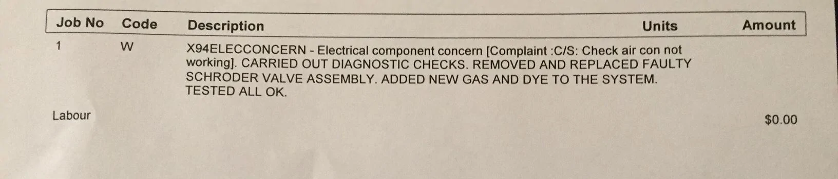

UPDATE: Dealer just called and said that they located a leaking valve in the aircon system which has been replaced and the system regassed.
Claims that the compressor isn't the issue on this occasion (but did admit that this is a known fault with the car).
Picking it up shortly - I suspect that I may be returning at some stage.

Just having a chuckle at the "Schroder" valve Drew....it should be a Schrader valve...It's the fill point for the refrigerant. ..Schroder reminds me of a name Jerry Lewis used often when he was impersonating germans in his comedy acts.
Haha yeah.
Google was confused about it too.
I was thinking Schrodingers valve. It could be in any state until you open the bonnet :D

Seriously though, if you have to have an aircon fault that is the best place for it to be. Easy fix.
