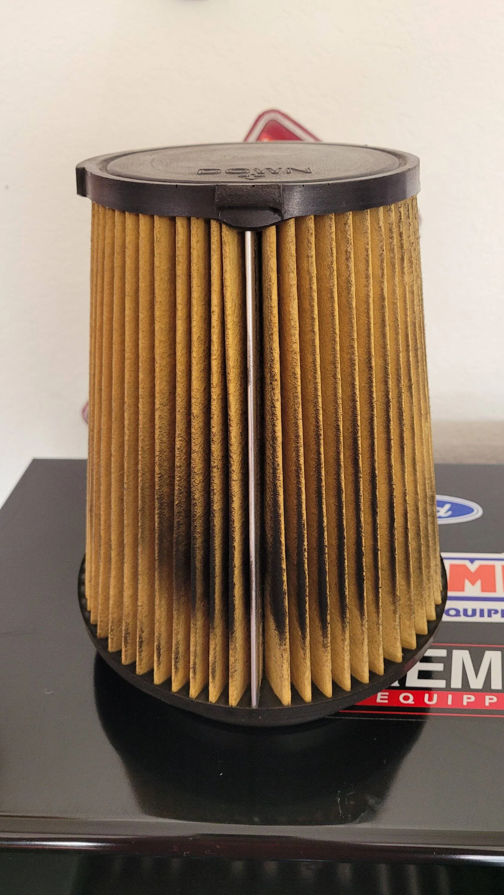

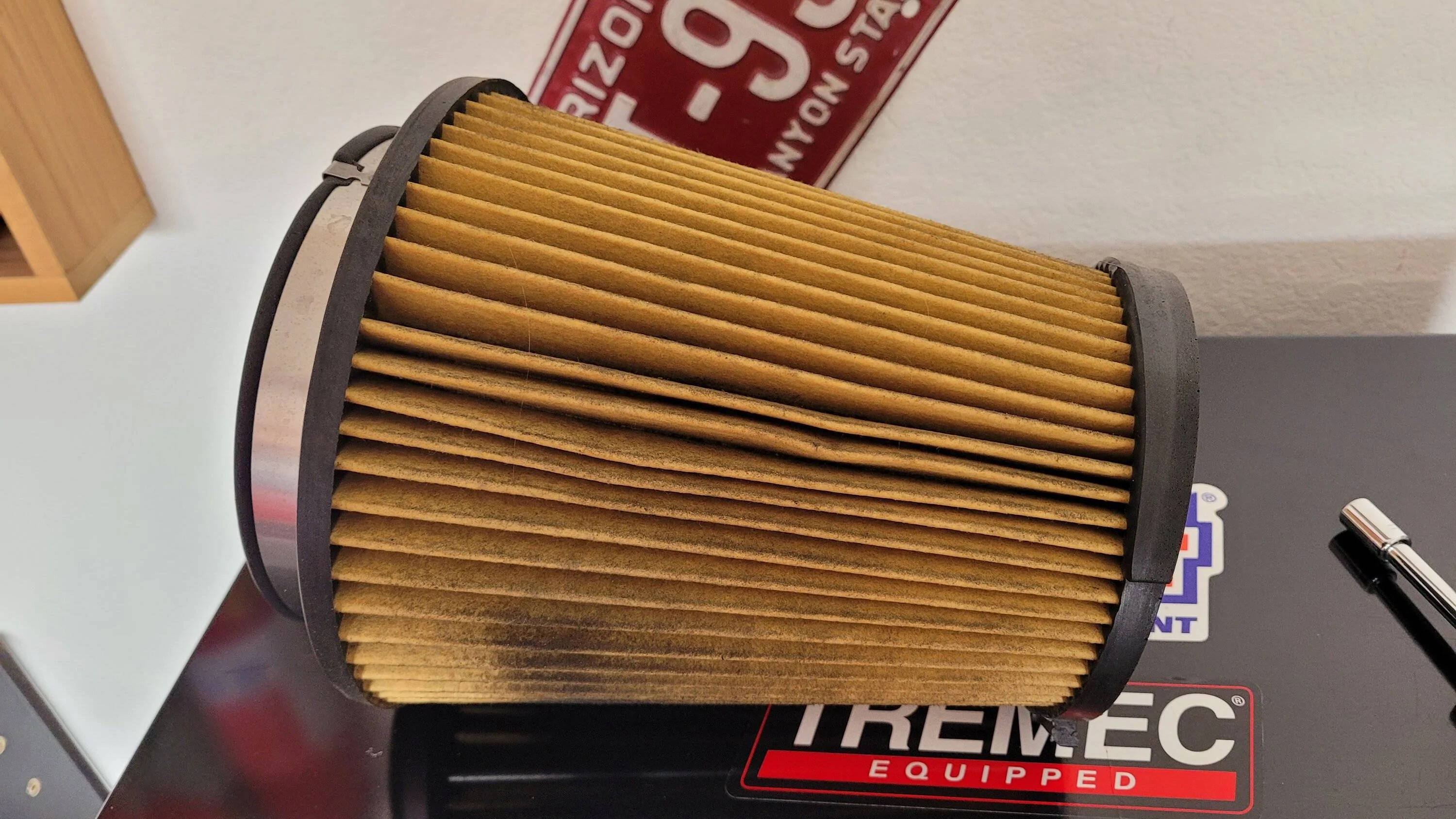

So is this normal after 5k miles? 🤔
Just to add, try the brand "Outerwears" micron pre filter on your CAI filter. I have it and it works great on a conical.
Outerwears link:
https://www.outerwears.com
The purpose of a prefilter is to block the smallest particulate matter from the main filter. An uncovered filter will clog much faster, whether it's a stock paper filter OR a "performance" filter. The prefilter will and does prevent the main filter from becoming saturated with debris AND at the same time it is deflecting particulate from itself due to its material and design.
All I do with mine is just use a shop vac to remove any debris from the bottom of the box and off the surface of the OW micron. Quarterly maintenance I'll remove the OW micron and rinse (it dries practically instantly). I've run it in full pollen season too and never had an issue with it clogging OR the underlying conical filter becoming dirty from pass through.
Here's my original Micron thread showing my Outerwears micron on my prior 2016 S550 after 5,000 miles of use. It's no BS, it works as designed and works very well. I'm using the same micron on my 2018.
https://www.mustang6g.com/forums/th...-tip-add-micron-sock-to-conical-filter.84459/
As one can see in the linked images in that thread, the debris is sitting on top of the Outerwears and isn't "clogging it" at all. If I tapped the Outerwears, that debris would fall right to the bottom of the air box. The same happens when there is airflow occurring, debris will deflect off the Outerwears and into the bottom of the air box. If the Outerwears was not in place, that same debris would have been packed into the pleats of the main filter.
