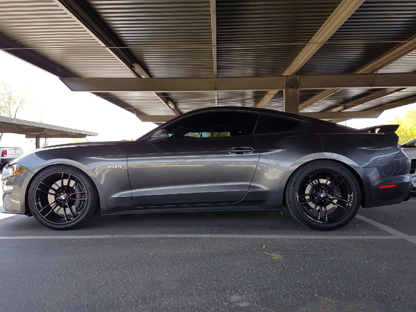

Here is the level side shot. Not a great pic but gives you an idea. On Ford Performance springs so the drop is minor compared to some only about 1" but ride is still smooth. May consider swapping later for an additional 1/4 - 1/2" drop.
The spoiler you see is the 2018 performance pack spoiler.

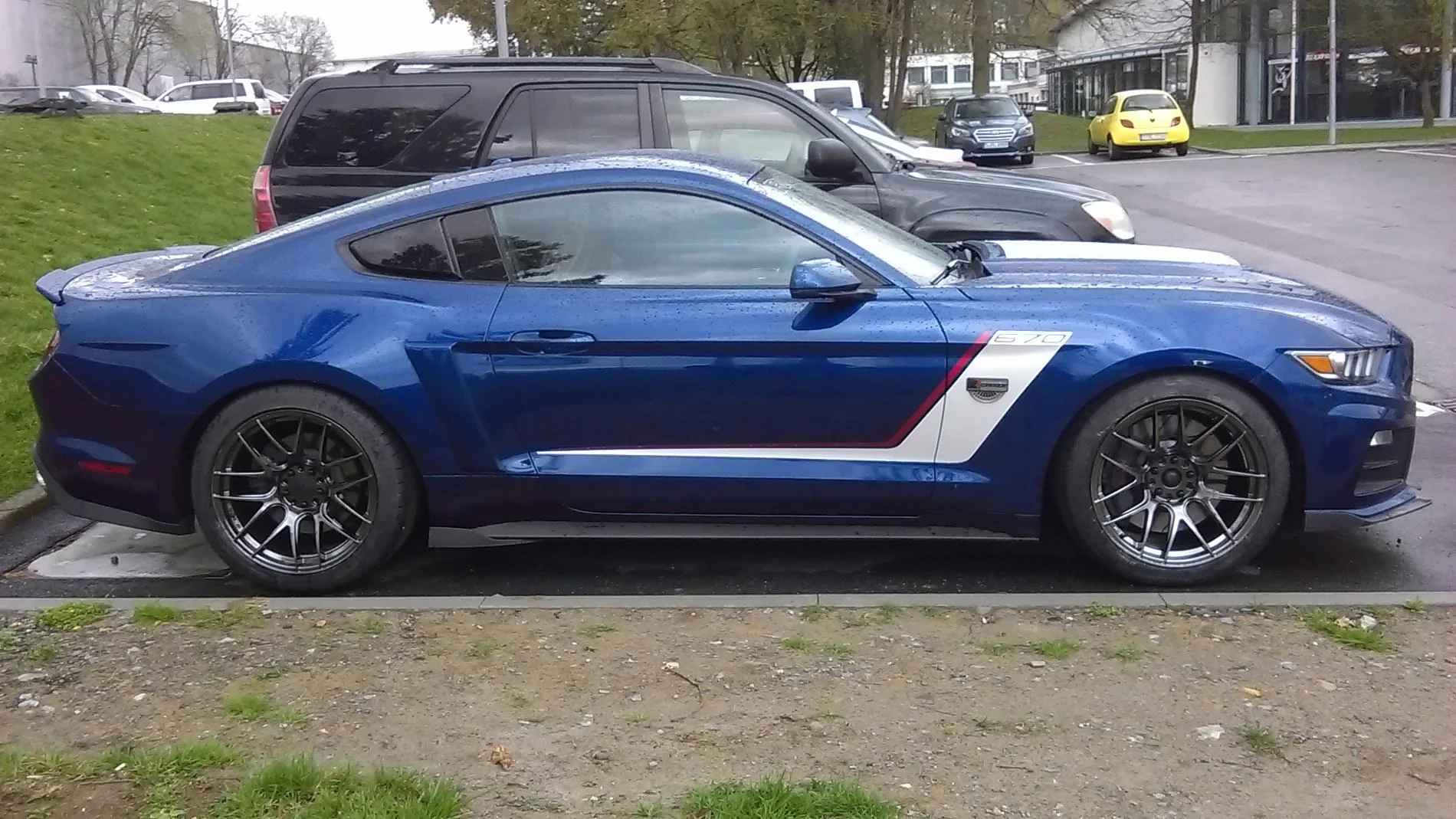

XXR 530 19X10.75 +35 Chromium Black (squared) with Michelins 305X19
