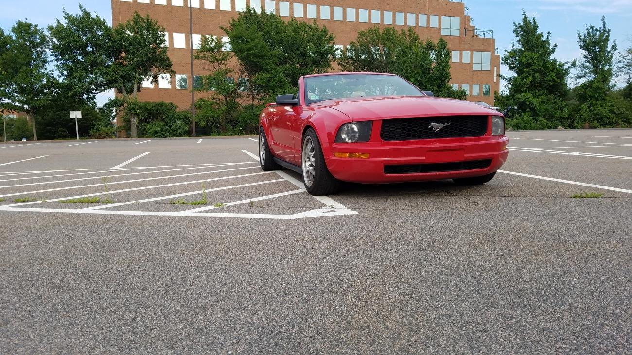

Lowered with H&R super sports up front and Steeda adjustible ride height with QA1 coilovers, 650lb rate in the rear.
GT500 rims with standard offset on Nitto's.

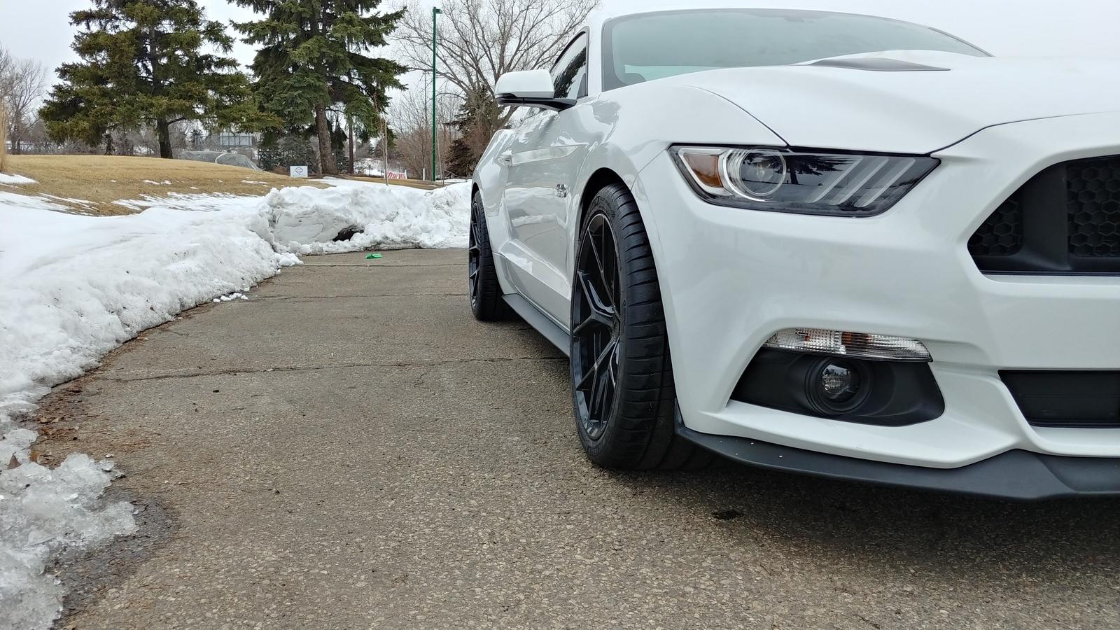

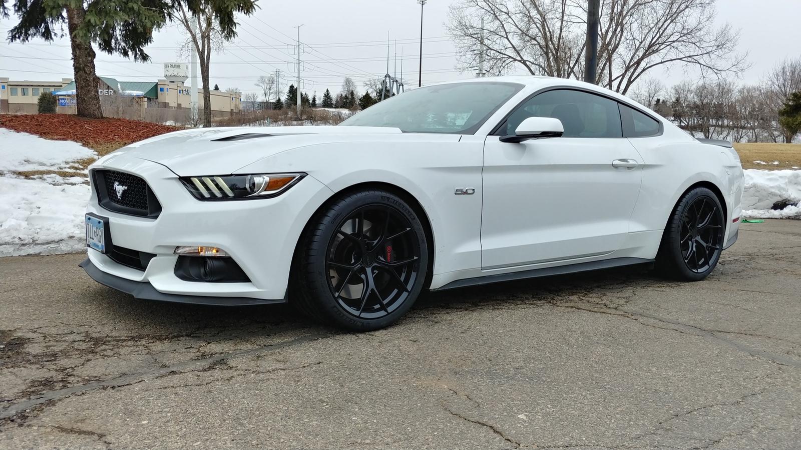

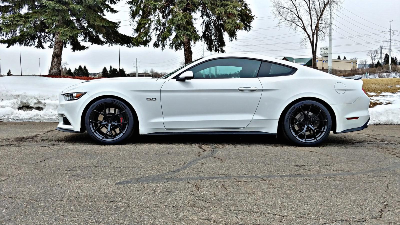

Just got my full setup installed (Thanks to Paul @ PK Auto Design for the setup!). 19x11 MRR FS06 all around (+30/+50 offsets no spacers) wrapped in 305/30/19 Michelin Pilot Sport 4S's! Weighing in at 58.6 lbs (5lbs a piece lighter than stock PP wheels/tires!). While I was at it, I also installed Steeda coilovers and Steeda sway bars. These pictures are about -3 camber in order to tuck the front tires in, otherwise they had some poke!
Car drives like a dream! Need to wait for this Minnesota weather to come around before I can get it on the track though (30 degrees out in these pics).

Awesome job !!!! :thumbsup::thumbsup::thumbsup:
