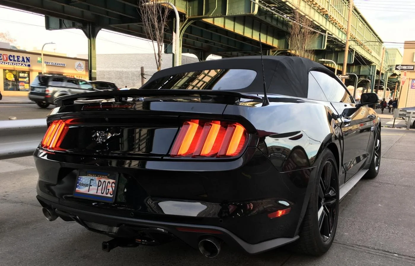

Gt/cs black convertible.
That same design, i.e., GT350 specifically made for a convertible, is also offered (direct) from BMC:
https://www.bmcextremecustoms.net/mustang-convertible-350r--spoiler-track-pack-style-2015-2017.html
I got mine direct from them, pretty quick turnaround.
There's some issues / concerns with correct color matching, especially with more complicated colors like Rapid Red, Orange Fury, so the consensus seems to be get it in gloss black, or unpainted and have that done locally.
One other thing: there was a user here who received the wrong part, twice I think! It was from the Ebay supplier, but anyway, if it's the proper convertible part, it fits like a glove, sits perfectly flush, no need to crank down on fasteners to try to pull the sides down.
I love mine, just works perfect with the convertible lines, the ends are especially nice how they follow the trunk/fender contours.

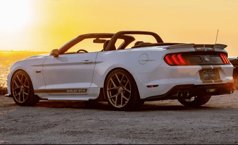

So, apparently in 2019 Shelby American's Super Snake convertible had this spoiler, but the only spoilers I find listed for sale on their site are "coupe only:"
Does anyone know or have any ideas about finding one of these? Thanks.

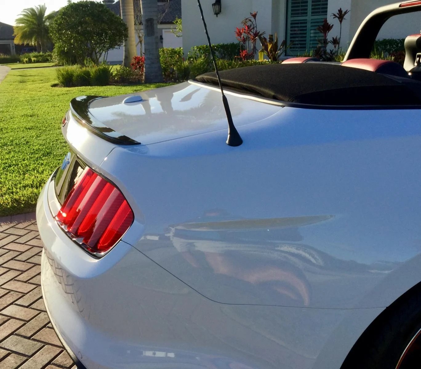

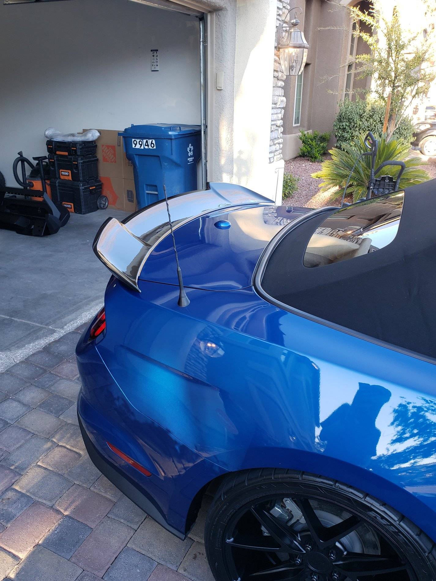

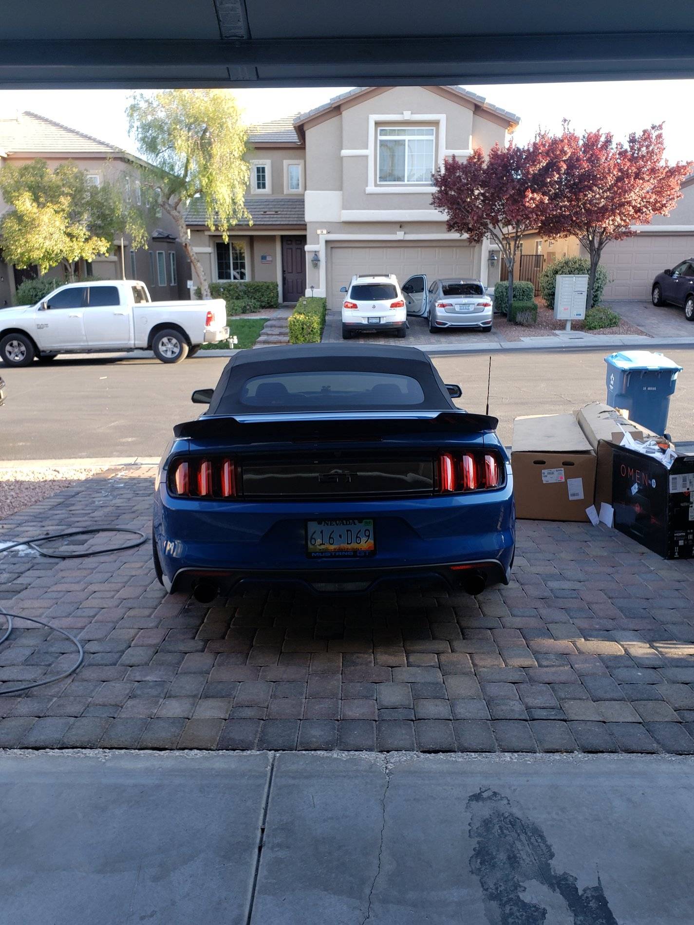

GT 350 tech spoiler on mine
Looks fantastic. Been looking for a spoiler for my vert for a few months and I think this is the one I'm going to get. So many of the aftermarket spoliers look like an afterthought (and even the CS factory spoiler) and usually end up looking far too big. The other one I've considered is the Foose MMD. I also think Rousch has one similar to the MMD> Not sure how much the Rousch is but the MMD is pretty expensive.
Do you have a link for this? I'd like it in white, but if it only comes in black I will paint it. Sharp car btw.

I bought used in the for sale section. It was a taken off a 2017 GT350. It is the tech spoiler that comes with the tech package

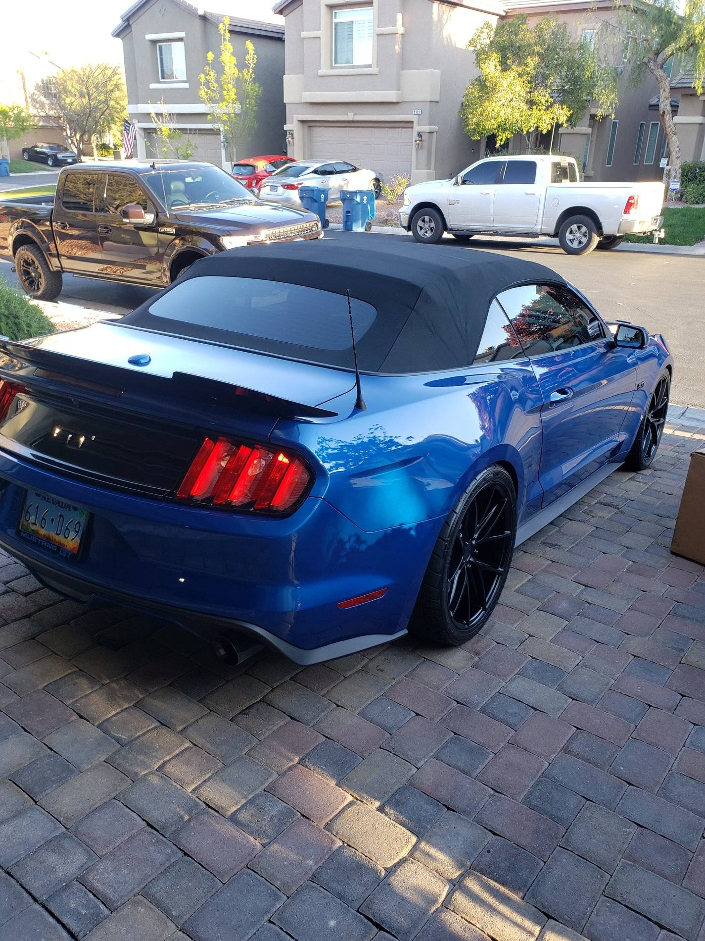

I added the Ford Performance GT350/500 spoiler to my PP1 convertible this afternoon. There was enough flex in the spoiler to fit the slightly curved convertible trunk easily.
