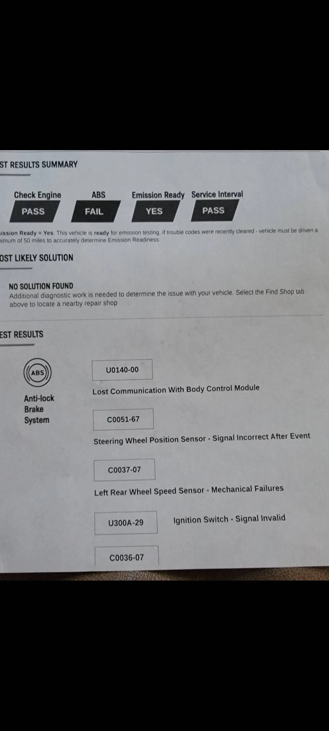

This morning the check advance trac, stability control, abs and power steering warning lights all were still on and the power steering is still NOT working. It was checked after disconnecting the battery for an hour. Yesterday, through
Amazon I bought a OBDLinkMX+ and it was delivered the same day. I ran it this morning several times and the result was NO CODES. I must be doing something wrong but I'll figure it out later. Went to Autozone and they did a scan which kicked out code C0037-07 which is left rear wheel sensor. It showed related codes that I'll attach in a photo but they're all related to the core problem which is the speed sensor. Remember that I pulled all four wheels yesterday and cleaned all sensors and inspected the wiring and connections. So tomorrow I'll be calling the Ford dealerships in an attempt to run down the part which is the same for both rear sensors
(FR3Z-2C190-B).
Saga to continue tomorrow hopefully with a positive conclusion.

Now swap the left sensor with the right sensor and if the problem moves to the right side and the left side shows no code, you’ll know for certain that the left sensor was bad.
Yep.
