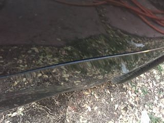

My rear trunk lid is also not aligned properly but I have not had the chance to look at it yet. From the way the rear glossy plastic panel is curved, I think the trunk lid sit too low from the factory which is causing the whole paint rubbing on plastic issue.
The trunk latch on the body side needs to be raised a little bit. Pretty common issue on the S550.
