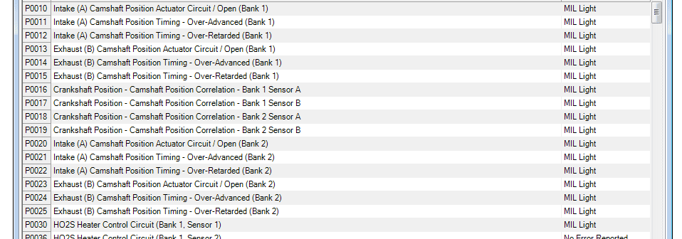

Pretty certain you'll throw a CEL code if you screwed it up. I'm sure you're good and ready for some boost.

Do you know what you to look for in a datalog to validate chain is off by a tooth. How bad will it run being off by a tooth because the car runs fine but idle is slightly irrattic
The code validates it. Idle will be off. If you clear it and it comes back you are off. Sounds like you only got one bank wrong
