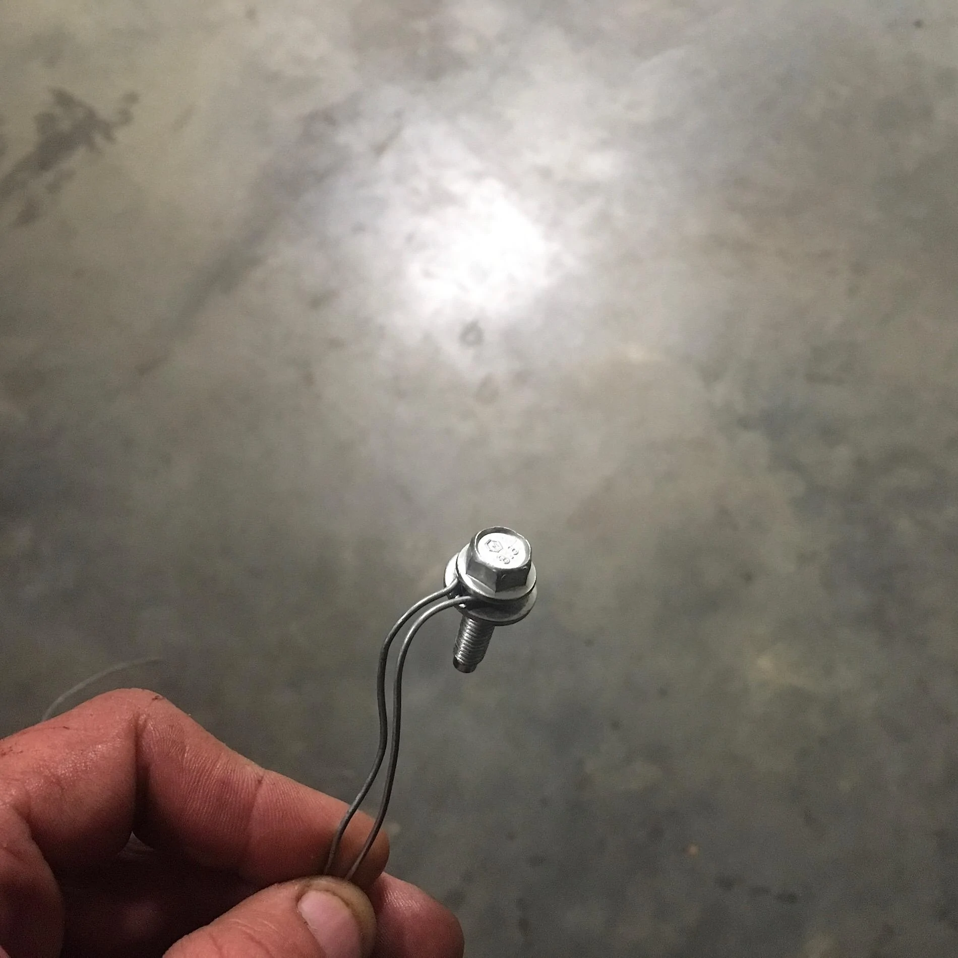

Not sure if this has been shown before but I see that most people have been using the electrical tape method when doing up that ultra-painful pick-up bolt.
This worked MUCH better for me.
Yes, I’m missing skin off the left finger. You’ll know why when you do the bolt :D

Ha, looks like you used the two finger method :) .... I was able to get the bolt almost all the way in using the tips of my two pointer fingers. I could see the left finger getting a little scratched up depending on how big your fingers.
Neat idea you have with the stiff wire. Also saw a post of a guys wife using regular wire to get it started
I couldn’t even get two fingers in there...(I’m talking about the pump bolt, not the other thing :ninja:)

Just did mine this weekend and I made a bolt holder out of a thin piece of metal. I think it was like a radio removal tool. Got the idea from a guy who used a starter shim. Drill the hole big enough to clear the bolt head, but not the washer. Very similar to the wire used above. I was scared of the pickup bolts reading everyone's posts, but it wasn't bad at all really. Plenty of other steps that are more of a pita imo.

I have a scar on my finger from doing 3 OPGs :cwl:
The wire is a good idea. I have had good luck with the electrical tape trick but I have needed to use a pick before to get out remaining pieces of tape wrapped around the bolt that got stuck when I pulled it off.
