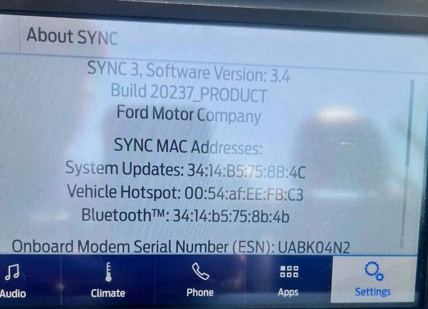

I looked at the settings in my car, and see I have sync 3, software version 3.4. But, I do not have navigation. I want to add navigation to my car (I prefer not to use through apple carplay, I want nav native in the system).
Question: Do I need a HARDWARE upgrade in order to have navigation? I have done some initial research - the web site Infotainment.com refers to the need for a hardware upgrade to replace the "apim module". ? But before I pop $600 for a new APIM module, I need confirmation.
2016-2023 Ford Mustang Sync 3 GPS Navigation Upgrade (from infotainment.com)
After that hardware upgrade is complete, I imagine I would then need a SOFTWARE update? (I would update through USB method)
Who has been down this road that can help? Thx in advance.

Infotainment here,
We are glad to hear you are considering this kit, this is one of our top sellers.
https://infotainment.com/shop/inter...3-ford-mustang-sync-3-gps-navigation-upgrade/
Many people have transitioned to the Google Maps, Waze, and Apple Maps functionality through CarPlay and Auto but we have found a great number of our customers prefer the OEM navigation and our hardware swap will introduce that into the vehicle. The OEM Ford part number for the Navigation APIM (MC3T-14G370- ACA, MC3T-14G370-ACE, MB3T-14G370-NCE) and the Non-Navigation APIM (MC3T-14G370-ABA, MC3T-14G370-ABB, MC3T-14G370-ABC, MC3T-14G370-ABD, MB3T-14G370-NBE, MB3T-14G370-NBG) are different so if you are using OEM equipment a hardware swap is required. Please let me know if you have any questions on this.

I don't know nothing about no compass GPS signal, as my car is too old. But if he is going to swap APIMs, he'll be doing about 80% of the Sync3 upgrade stuff. Would be good to know if he can skip the antenna, for sure. Heck, the maps may already be on the APIM...

Ok Vin shows GPS signal. This is built in, you would not need an additional antenna.
NAVIGATION MODULE GPS ANTENNA: ICPAB0 : Module/GPS Antenna
