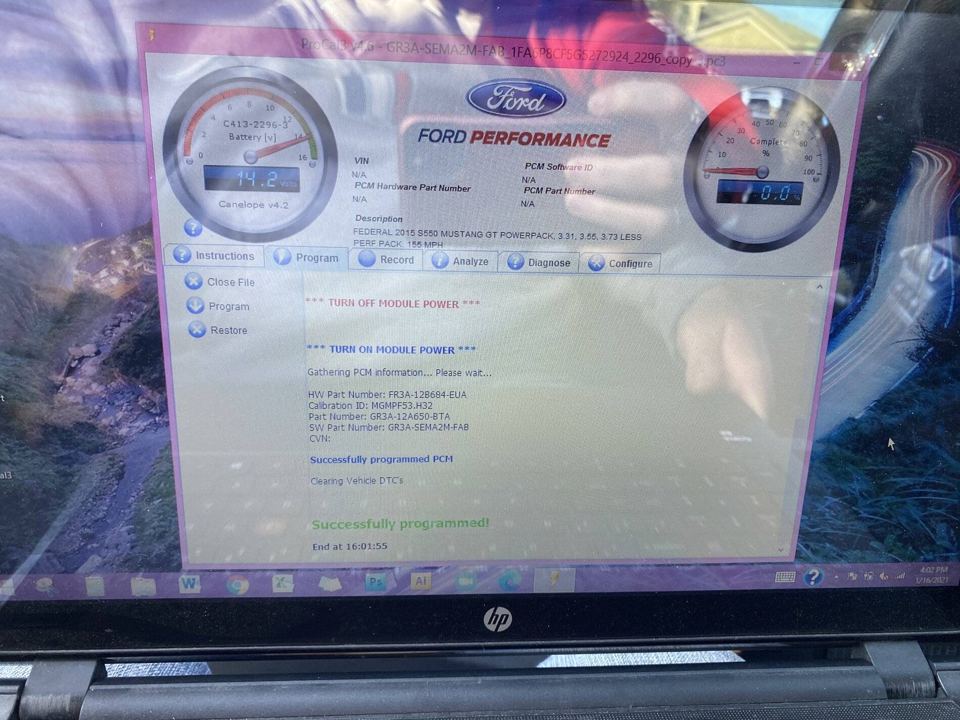

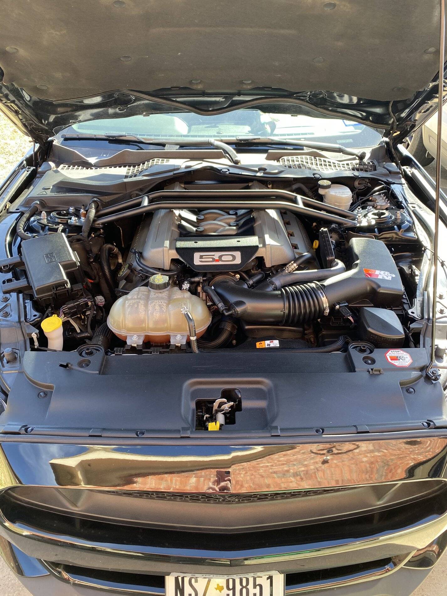

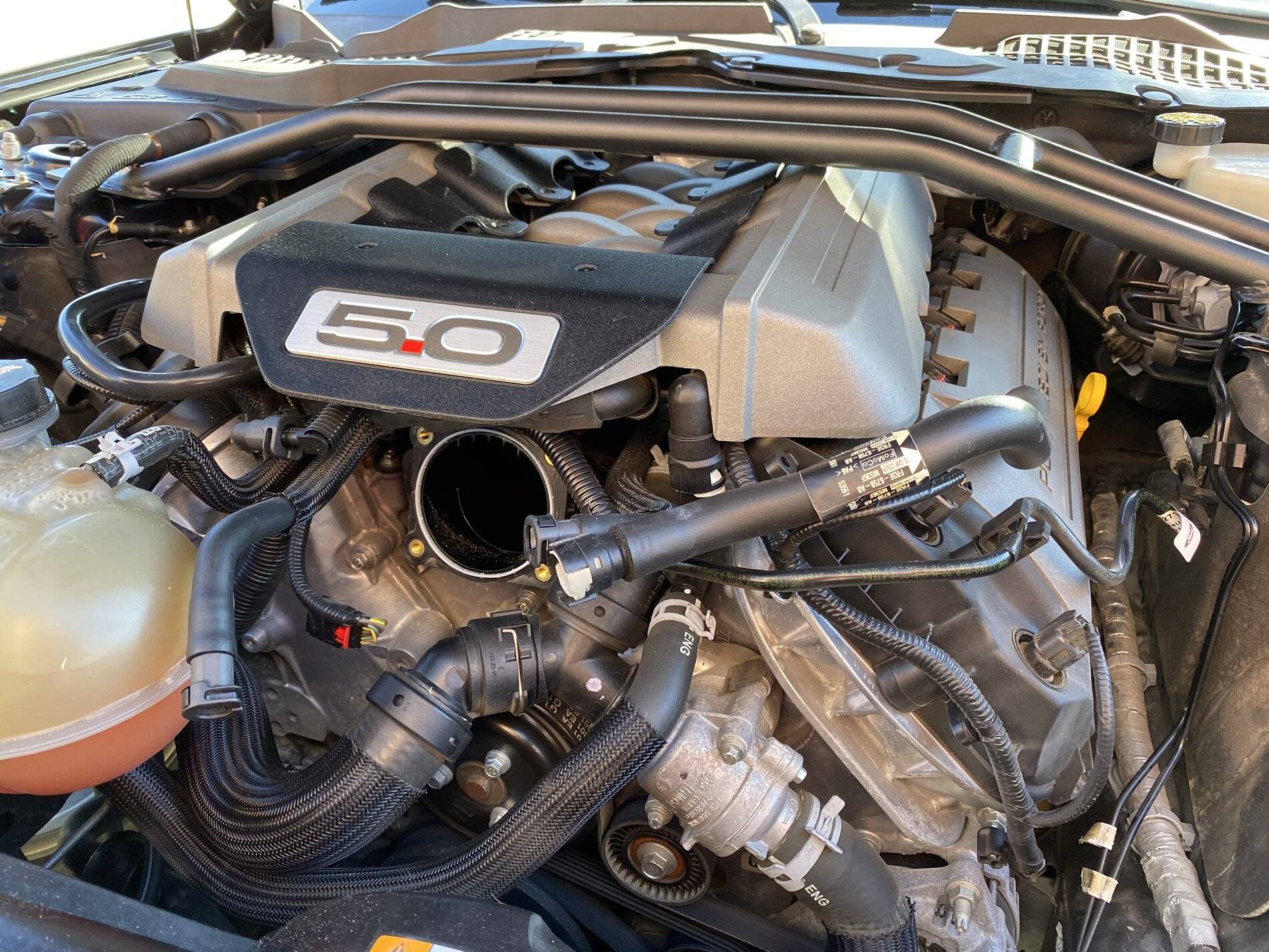

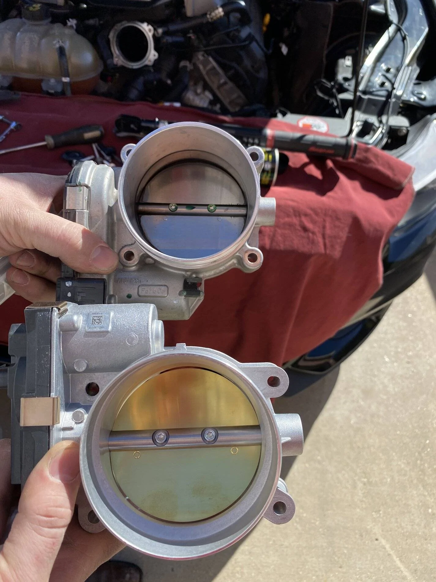

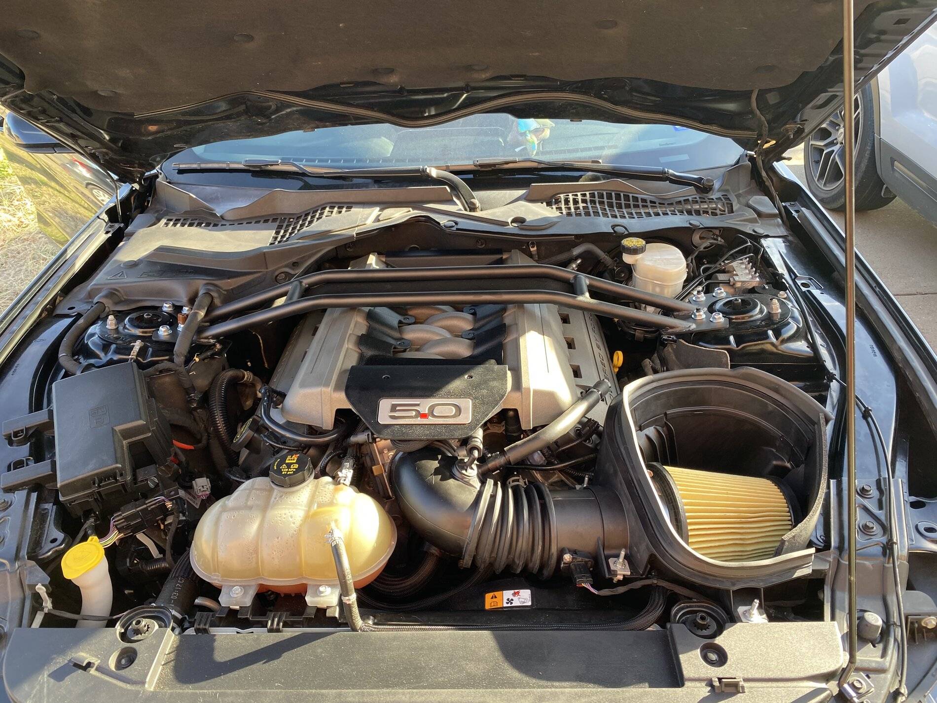

Last week I added the FP Power Pack Stage 2 . Installation was seamless and less than an hour including download.
The car started immediately and there is a slight but noticeable change to the sound even at idle. Definitely gains at low rpm and pulls hard past 7k . No lift shift is seamless and glitch free.
it is definitely quicker and the mid range is stronger. lost about 1mpg running cruise control at 90 otw from Dallas to Houston.
I’m very happy with the end result and until I go FI this will do me just fine. For an out of the box addition I think it off very worthwhile unless you’re chasing every last horsepower or a perfect tune.
The bolt on the firewall wasn’ta big deal, and fit was excellent.

Excellent pictures. Nice to have before and after pictures of components.
Thanks, we had a really good time doing it and driving it after lol
