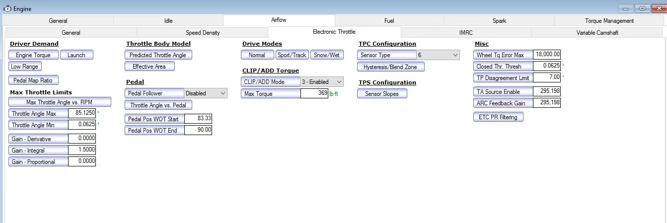

These are the tables that are directly related to Throttle. Notice there is a lot that affects your pedal's relationship with the throttle blade. The Normal, Sport, and Wet tables are only there to allow changes to the modes without altering tables that affect the other modes.

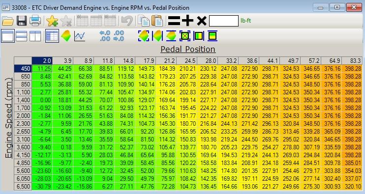

This is the driver demand table. Notice that going from 50% pedal/throttle to 50% pedal / 60% throttle only adds 30-40 ft-lbs of torque. It is only designed to make the throttle feel more responsive.

So much is taken on faith when you're paying for a tune from some one. Didn't you say that's why you started teaching yourself to tune? I would love to really know how much of this stuff is altered with the standard "bolt on" email tune you get from most tuners. And same goes for custom dyno tuning. You can't help but wonder how much time is saved by the tuner really not messing with some of this stuff bc the average customer has no idea what can actually be done. Or if you're tuner to try and explain to your customers why you're worth their money bc you actually spend time on stuff like this. When they have no idea what you're talking about haha.

What decides the torque value after a modification is made when more torque becomes available to use? Do you manually change the torque number and it automatically fills in the values? Or you have to do it all manually? Sorry, I'm very inquisitive, I better just start looking for books or I'll have to start paying you to teach me haha

Most of this stuff is not part of a normal tune. Getting the AF ratio and spark timing are the big parts. The newer torque based systems require more changes but once you know what you're doing then it's not that bad. Everything else is definitely more personal preference than necessity.

There is a torque model that is created by Ford to create a map or guideline as to how much power is made at any given load or RPM, etc. The model can handle pretty much any naturally aspirated deviation but with FI it can close the throttle as power levels begin to overcome the model and the ECM tries to keep it within the model. Part of the tuning must allow the throttle to remain open to even begin to start tuning AF ratio and spark. The torque model can be remodeled if needed.
Often the Driver Demand table is left stock or close to stock, especially with Fords as it is only a Demand table. Fords switch to a "full throttle" mode after a certain throttle percentage and rule out the Driver Demand table. GM applications use the 100% row of the DD table for WOT so it has to be changed quite a bit in some cases.
