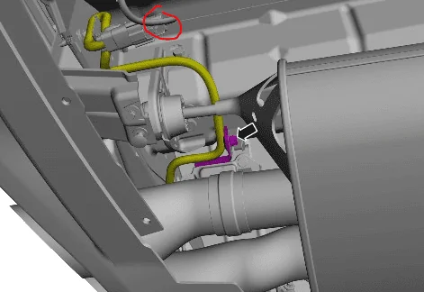

i love my AE. i am high flow catted with no resonator. may be work a quick look under the rear of the car to see if you have the part of the harness before the jumper to the actuator. Since AE came out for the GT in 2018 and 2019 for the ecoboost,maybe your car has the majority of the harness already installed.

Yes it has the entire harness there and should be good to go, thank you for sharing the diagram 🙏🏼
Do you have any sound clips of the high flow cat with active exhaust?
