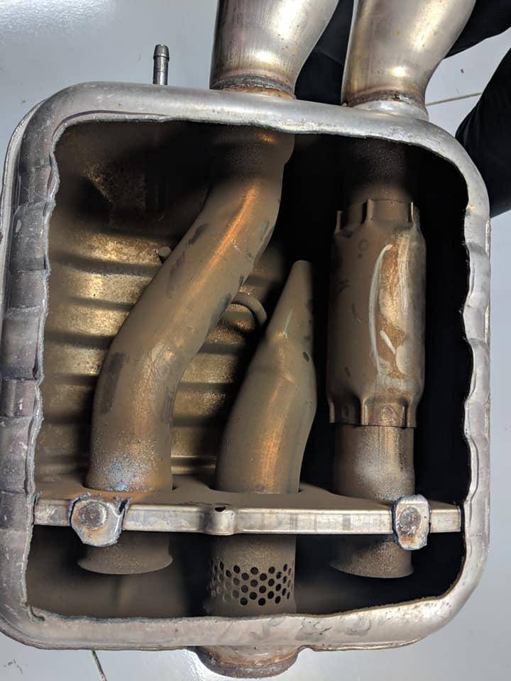

If ford used the same type of muffler on the non active 650 as what they did on the non active 550, I can understand why it drops a little power.
The 550 active exhaust is straight through once the valve is open, but a 550 non active has this to contend with :
