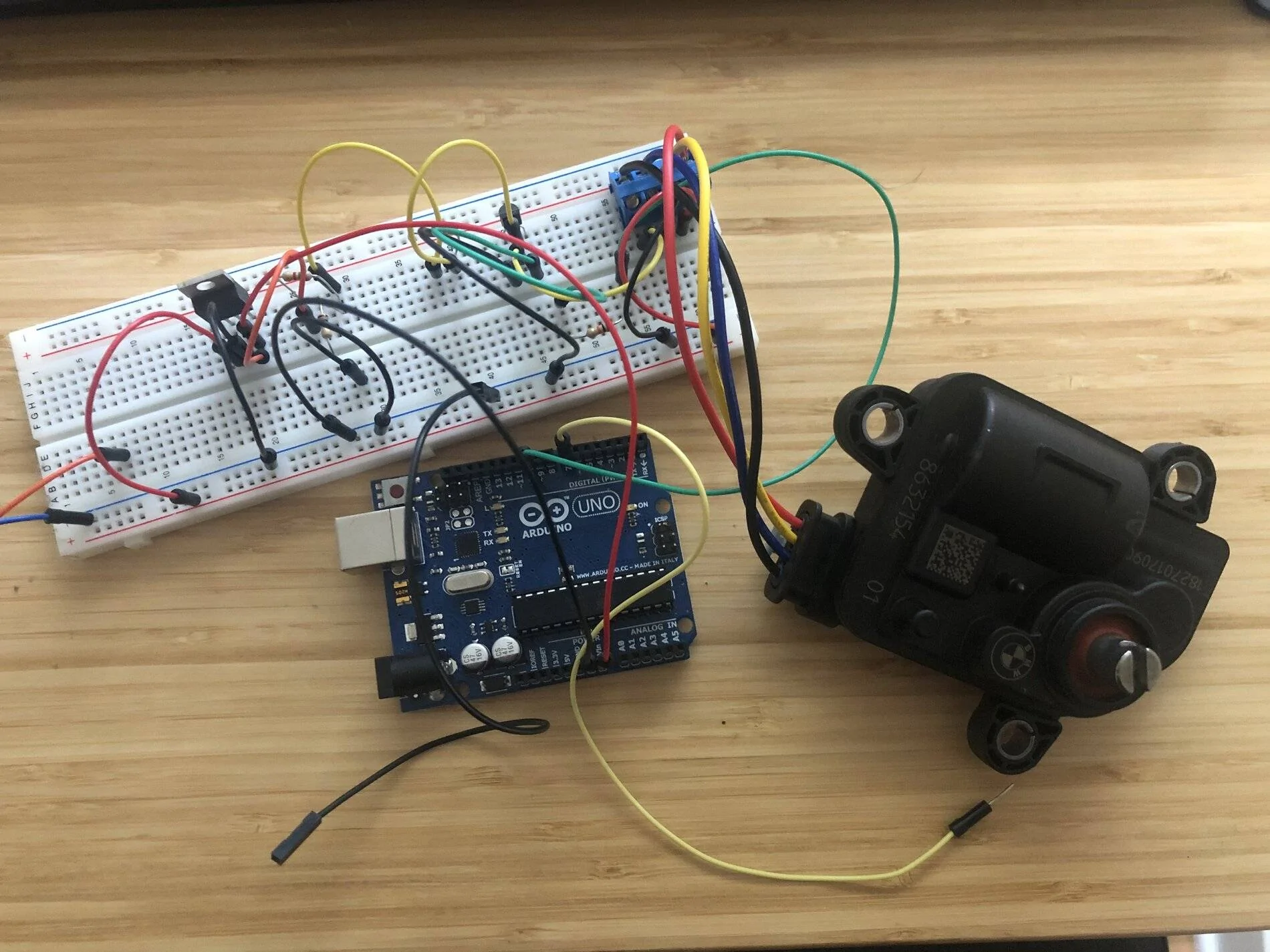

Hacking together an active exhaust setup using Arduino. I am actually using BMW exhaust valve actuators as they can be found for cheap on ebay + they're all made by one and the same company.
Got the actuators to spin both ways, next step is to solder everything up and add a fancy switch LOL

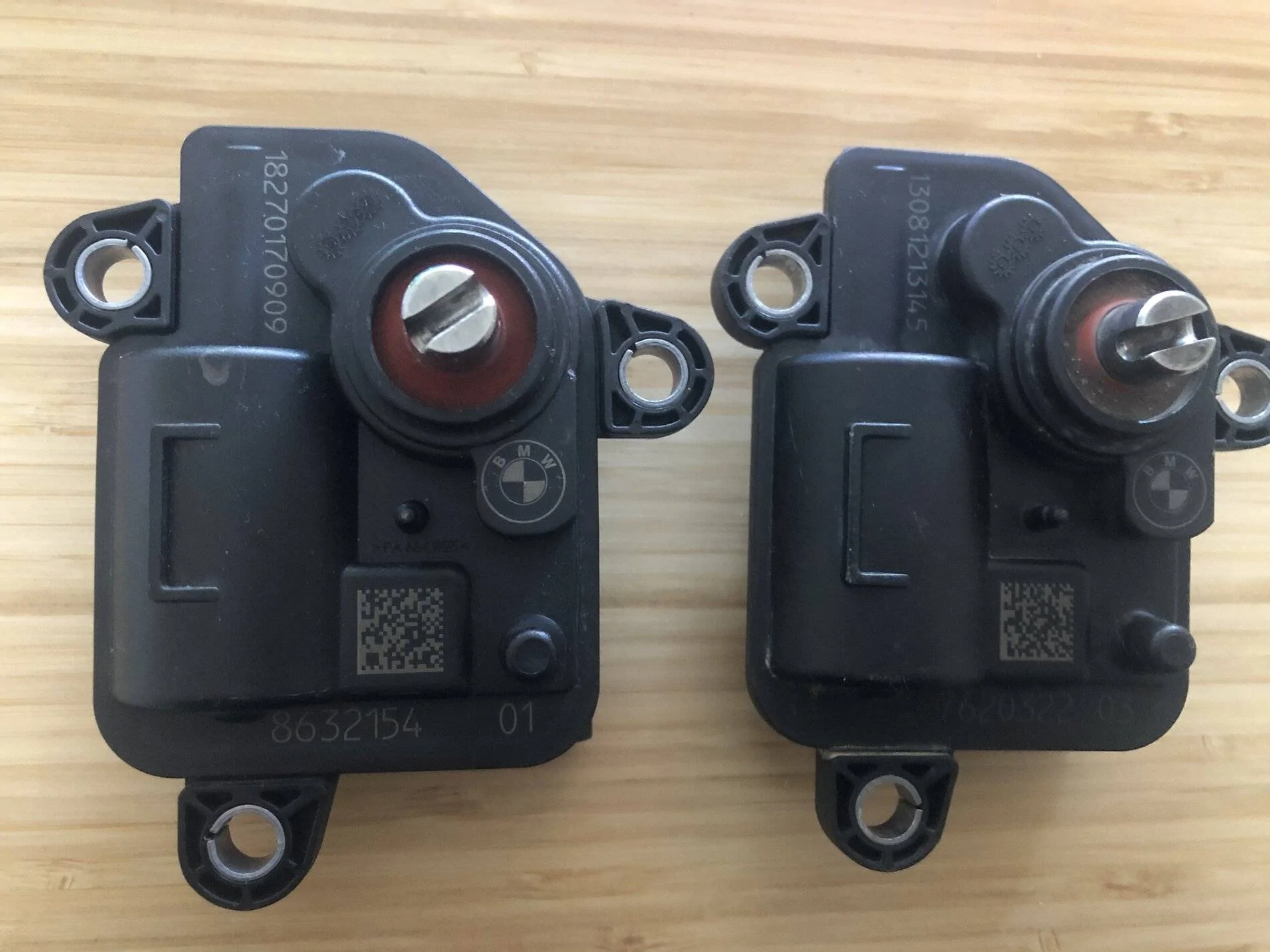

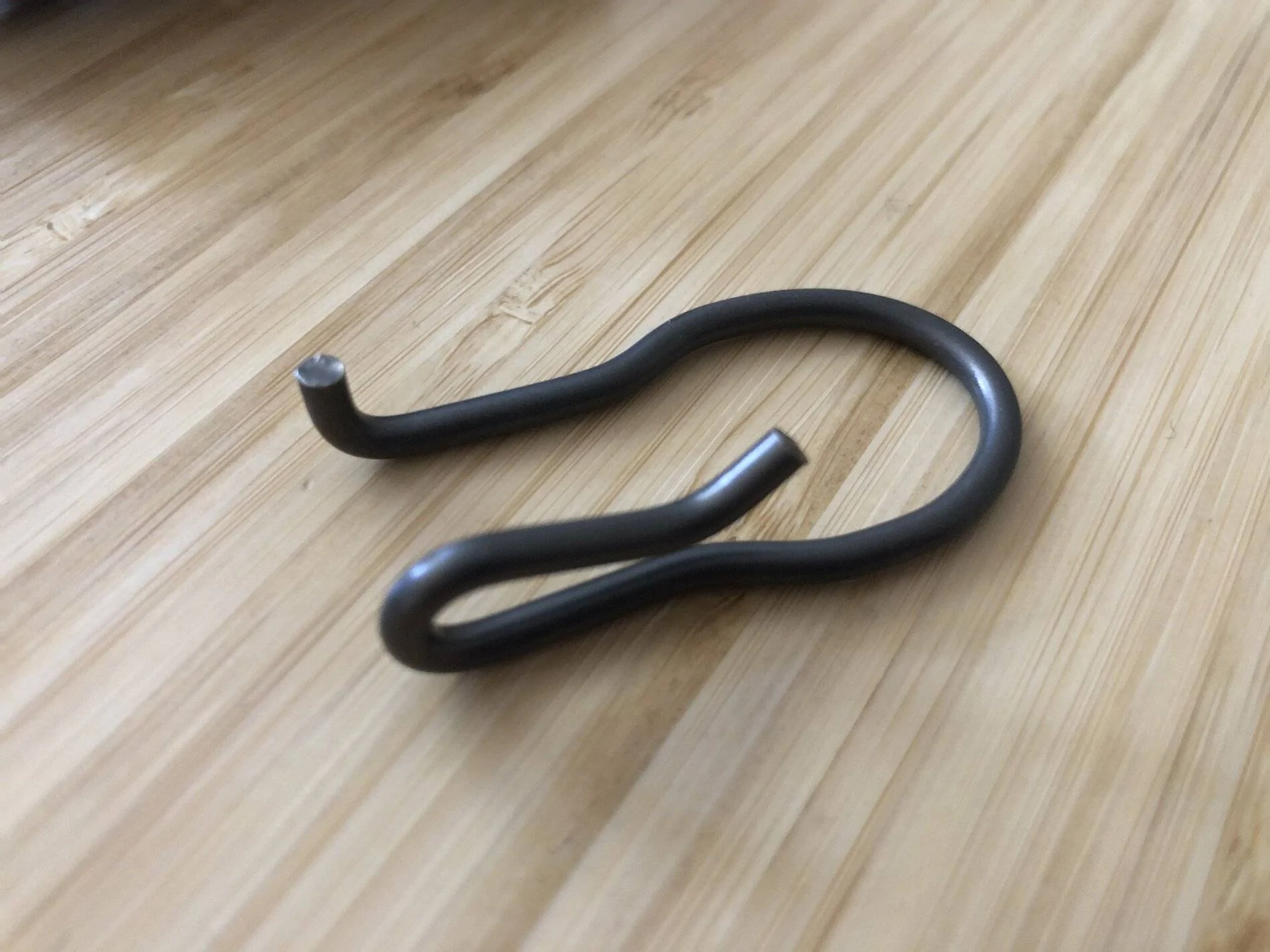

Just tried doing a test fit and those BMW coupling pins are too long, they hit the side wall of the actuator base. Tried tweaking one and ended breaking it. Looking for an alternative solution.
very interested in your setup. I ended up hardwiring the motors like in the other thread, but I’d love to do it a little better in the future and not have to hack them. I’d also like to figure out presets for modes.
Option number two for the springs would be to add new notches to the valves on the muffler that are ~90deg opposed. That might just do the trick and you could use the Ford or BMW round style springs without having to change the clocking of the shaft on the actuator. (Dodge might have something that works too)
That would def solve it. Just not sure what tool to use as there's not that much space on the top.
Dodge actuators use the same setup as Ford but I'm having a hard time finding those springs online - that's why I originally started looking into the BMW setup, it's easy to get it on ebay.

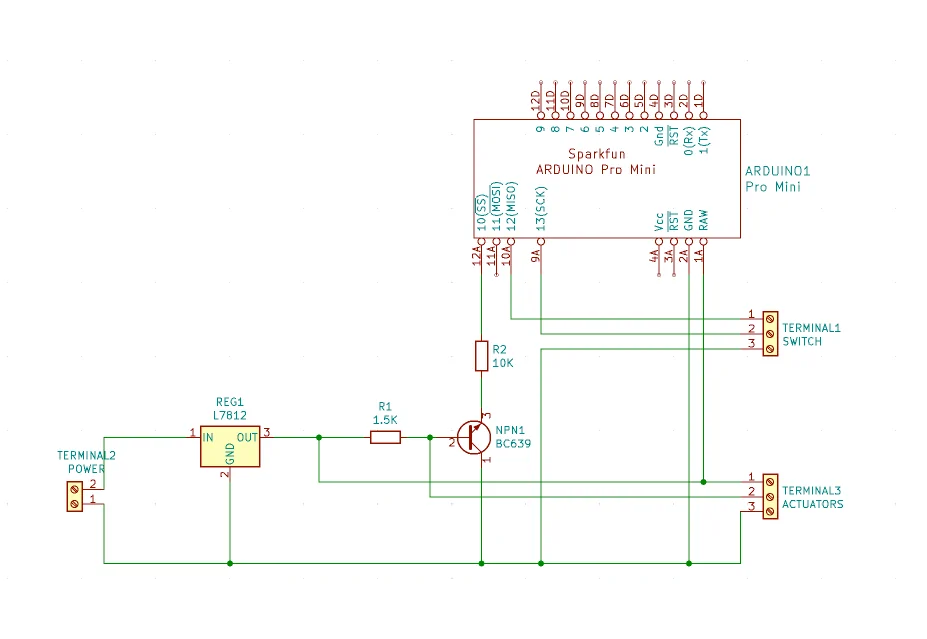

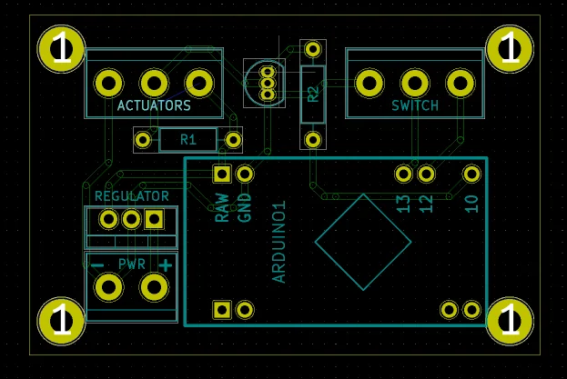

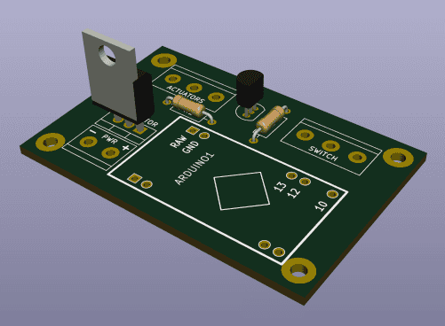

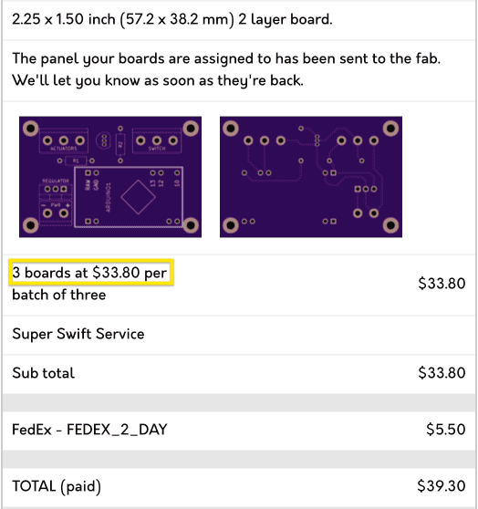

To shed some more light on the project...
Soon after I started digging into those actuators, I found out that they're all made by the same company called Kuster. Ford, BMW, Volvo etc all use pretty much the same actuators (with some small differences). This kinda peeked my interested so I continued digging.
I soon found that they use the PWM (pulse width modulation) control protocol which helps optimize energy transmission and deliver a digital-like signal via an analog circuit.
After some more googling (this time armed with the right keywords), I landed on a super interesting forum post where a guy from Australia posted his working setup (based on Arduino). I didn't have the exact same components laying around as in his schematic, so I hacked together a circuit on my breadboard using what I had, turned it on and... nothing. So I ordered the same components he used in his setup, connected them from scratch, turned it on and... again, nothing. At that point I was like, ok wtf. Then I noticed his actuator enclosure was different, which got me thinking about the actuator pin positions so naturally I moved the outputs around but still couldn't get them to work. I was still not ready to give up so I went searching for BMW service docs, trying to locate one that would tell me more about how to hook up the damn thing... and I finally found one, moved the outputs around based on their schematic and BOOM, they moved... but only one way LOL. It took some messing around with the PWM duty cycle to get them to move the other way.
I rewrote the original Arduino code from scratch in the process because it was doing some things that didn't make much sense to me. Next step was putting together a project in KiCad and then getting a PCB board professionally made by OSH Park - still waiting for it to arrive. I will actually be getting an extra 2 PCBs so shout at me if you need them (you would need to get the components and solder them). Plus I think those can be made open source, meaning they can be ordered directly from the OSH Park website. If there's interest, I can post KiCad project files, bill of materials and full source code as well.
All in all, this was one crazy ride but hey, I love hacking things so kinda enjoyed it :)
