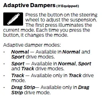

Okay so I have had my car for 5 days now and I'm reading the manual tonight and I noticed that the manual states there should be a button on the steering wheel to change the active dampers. I looked but my wheel doesn't have it. I ordered Magneride and my window sticker has it. Anyone have this button?

Bravo for reading the manual.
What trim level do you have on your car - base or premium? Premium has the 4 paddle switches on the center console, the right-most of which cycles through the drive mode (the 4 modes they are talking about in the manual).

I am a 2019 Premium GT. Okay sometimes I would like to change the suspension without changing the full mode.

Ah, ok, I don't have magneride, so there's something extra you can control that I don't have experience with. I can control steering wheel feedback (third toggle) and exhaust mode (pony button) independent of drive mode, but you've also got suspension that I don't know about.
Edit: I downloaded the 2019 manual (http://www.fordservicecontent.com/F...-Owners-Manual-version-1_om_EN-US_05_2018.pdf) and I don't see the reference you're showing. Where is your manual from, and what page?

Hmm I did not know that it is possible to select different damping mode when being in normal and sport I would love to though
I can only select the driving mode and the damping adheres to that mode. Did not know or think it is possible to have normal mode one steering, exhaust and sport on damping.
I have Magneride and I don't have a button for "adaptive dampers"
Where did you get the manual from? @slowrey

This note is in Ver 2 of the manual but not Ver 1. My GT was built in February and I don't recall seeing a steering wheel selection for Magneride.

My guess is that it is an error in the manual. The GT350's have that setup/steering wheel layout. If you go to the online manual for the GT350 it shows the wheel layout shown in your manual which is different from what your car has or what previous GT manuals show. https://owner.ford.com/tools/account/how-tos/owner-manuals.html?gnav=header-owner
