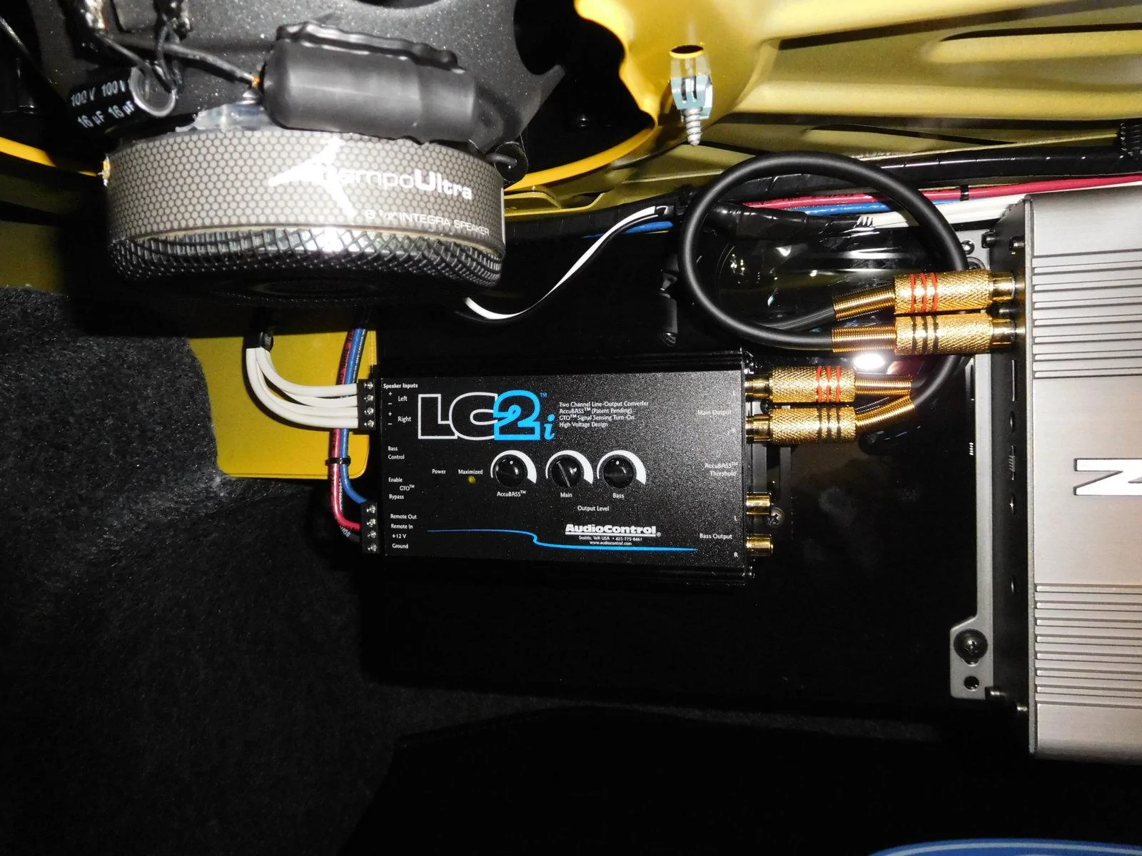

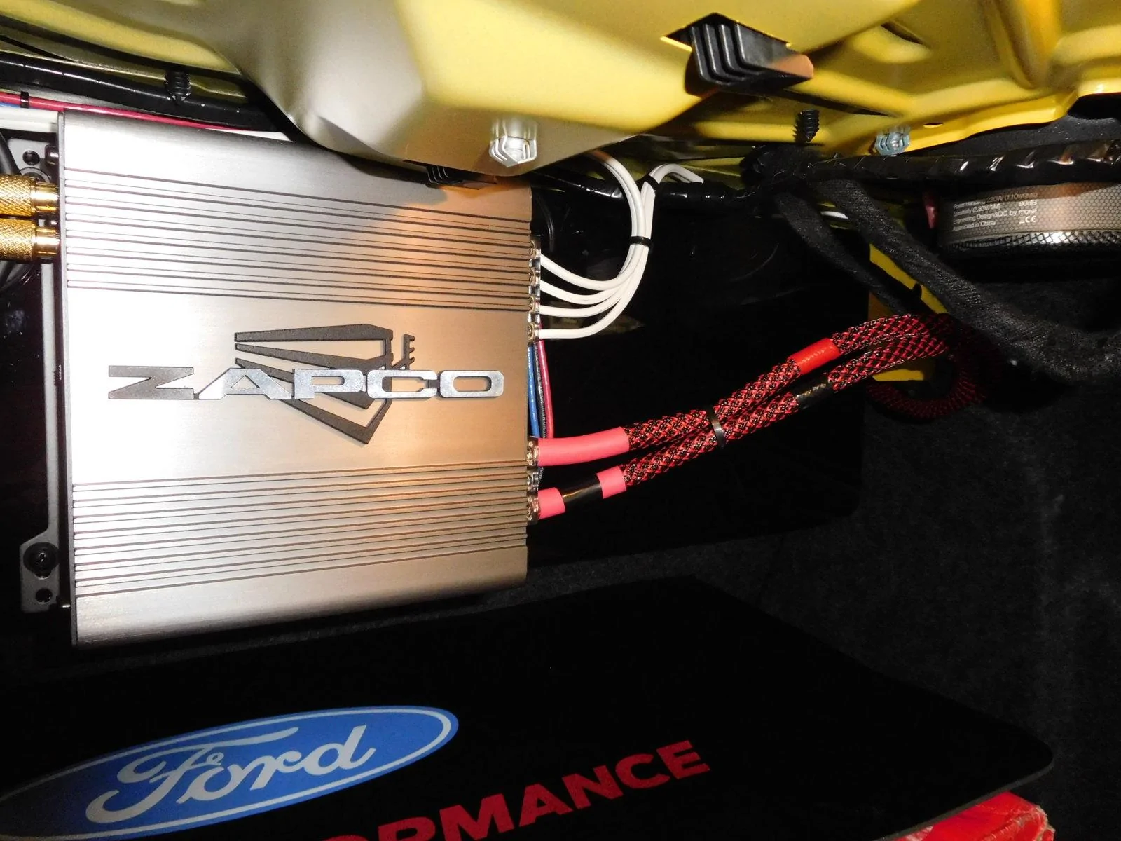

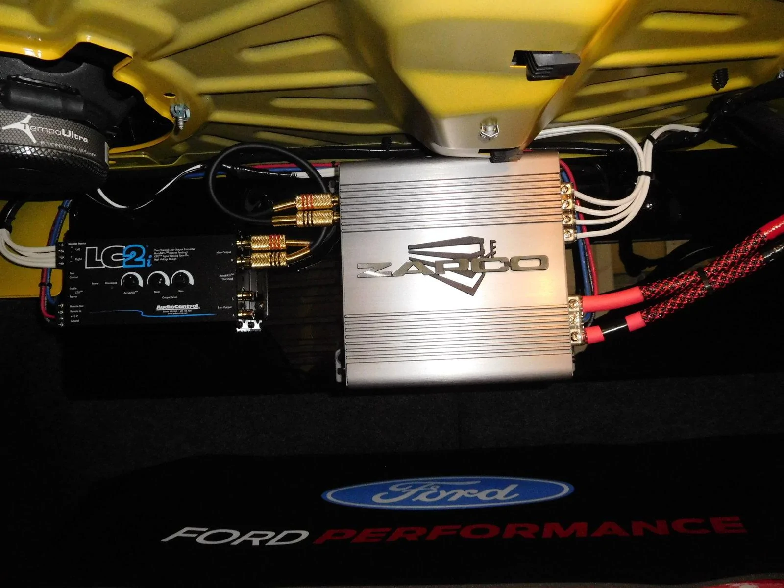

I did a complete rear deck speaker upgrade including a DSP and an amp. Yes the side panel removal is necessary to remove the rear deck panel. This guy in the video is a butcher in my estimation. Crutchfield sells adapter plates that work extremely well that will save using bastardized speakers for adapter plates. I still have yet to do a patterned perforation of the rear deck lid to allow more sound to pass thru. i bought the punch tool from Harbor freight. A broken ankle has put a damper on my MODs this fall.
