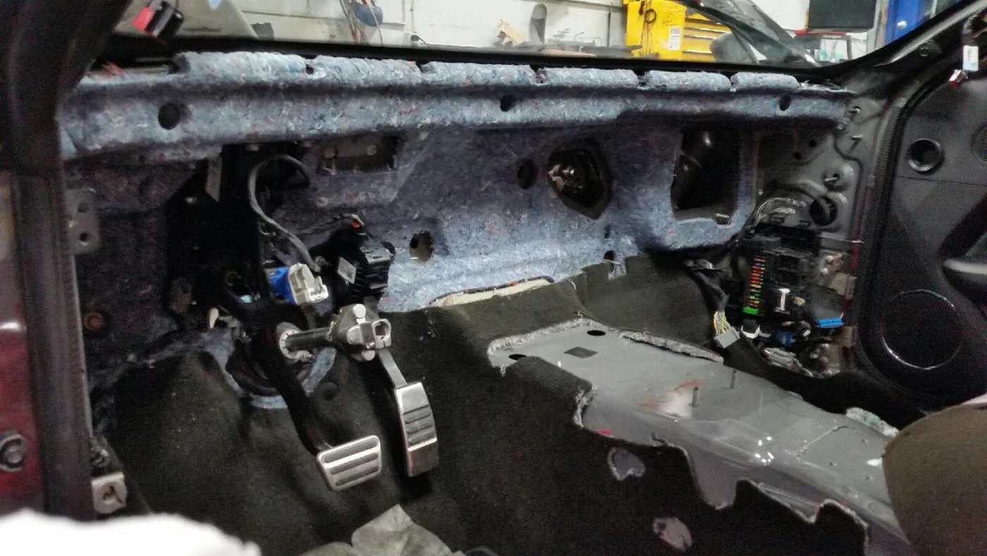

I waited 6 weeks for the back-ordered evap core. Lucky for me I added some refrigerant and my A/C worked and I had my car until the parts came in. After that it took 3 days in and out...whole dash and console needs to come out. Here's a pic the tech who is a friend of mine text me in the middle of the job...the end result is great...no rattles or noises and the A/C works great.

^^^ What a complete cluster f#*k - great engineering with service/repairs in mind. Anyone have a photo of the evaporator that fails?

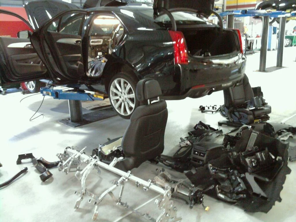

Unfortunately it's the norm for this kind of problem. This is what happens if my Cadillac needs this:
Would you get your tech friend to get the manufacturer name or any other information off of the original and the replacement evaporator?
