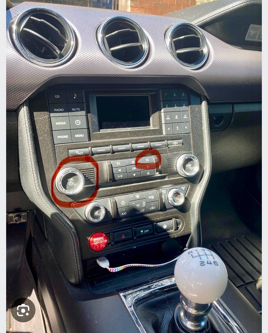

I tried to reset it thru disconnecting the battery for 30minutes, but I dont know if that is the right procedure.
Do you mean the buttons that I have circled in red on the picture?

Disconnecting the battery will clear DTCs but doesn't reset/reboot the FCIM/APIM. I believe those are the correct buttons. A YouTube or Google search should turn up a tutorial.
I have the larger screen in all my Fords and did have an APIM failure in my '12 Edge. It's a known problem that usually presents as a black screen. I don't have any experience with the smaller screen but it is my understanding that it can be reset/rebooted with that procedure.
Good luck.
