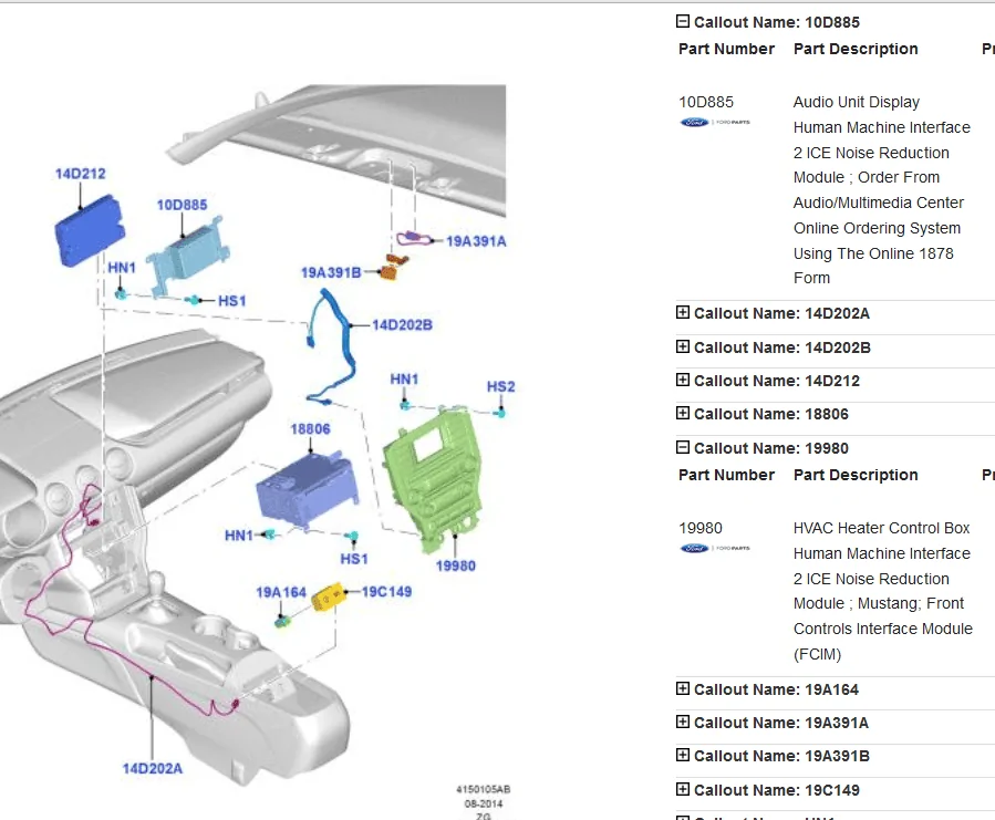

Ok. Got a call from my service advisor. Dropped the car off last Thursday and was told that they were replacing the FCIM. Car was done later in the day. So far not issues anymore. Constant blower speed. I attached a copy of the repair order.

Interesting. The part number listed on your work order is called "
Audio Unit Display Human Machine Interface 2 ICE Noise Reduction Module" on this diagram.
Lol..I looked over the RO for another part number but nothing..it's weird the tech labels it as the FCIM but the part number describes something different..Unless the tech used basic terminology in describing the part? FCIM might be a more common description then Audio unit display blah blah blah......maybe someone with more knowledge might chime in..or any ford techs on the forum?:shrug:
Edit. Never mind I see that part #19980 is labeled as the FCIM..Thats weird

I converted to MFT, and while I've had the front panel off several times I noticed that the blower motor would stop surging. After removing everything and putting back together for testing.. In other words, everything not back 100% , it would surge again. I finished the install, made sure everything is tight and have not noticed any surging. Makes me wonder if it could just be poor connection to the FCIM or in the module. :shrug:
Not sure what in stock form controls the climate. Now the APIM allows it to Sync and can also control via voice commands. I never tried this stock, so unsure if it worked.
The oddest thing is before I would have to have the blower speed on 3 or above to feel like I was getting any air flow. Now, I can keep on 1-2, and after car cools off, 1 freezes you out of the car. Feels like the same airflow i used to have for speed 3. Know others have mentioned same issue as well. Odd... Definitely odd.
Sounds like the tech did his job and found the issue with Jesse R car. Time will tell. This just makes me believe it's somewhere in the FP. Can't be CB, as I'm using the stock one. Would like to see someone else go to Ford and have the FP checked.
